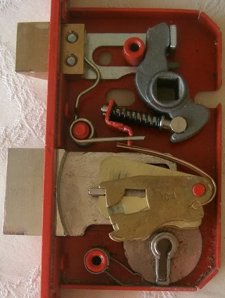

Postby chrisjc33 » 5 May 2006 5:35
can anyone ID this lock?
it's easy to pick and has spacers but would be nice to put a name to the face

Postby haribo » 5 May 2006 6:57
Hazzard a guess a Wallsall 55?? Although they are normally black

Postby Shrub » 5 May 2006 7:11
Yes i would go with a A55 as well thats in red for some reason, maybe a hardware store re-coloured one.
Everything else is identacal.
Postby pinky » 5 May 2006 7:25
your all correct about the lock guys, but in red its an Abus, it is the walsall lock but badged as an abus lock, also as a york in red.

Postby chrisjc33 » 5 May 2006 8:28
martin wins all my respect and well done to the runners up
it is an abus i found the face plate in a cold dark corner of my van

Postby pinky » 5 May 2006 20:22
ah but an easy lock to id at the end of the day, only 2 current locks have a h/p that runs straight across top of curtain, era and walsall / abus, era now has 2 dimples but has always had a dull dirty looking curtain, the walsall abus has always had that nice shiny curtain that doesnt dull.
the walsall lock currently comes in black, as walsall , wks and es and in red as abus and york.
the non bs version comes in an array of colours and names
