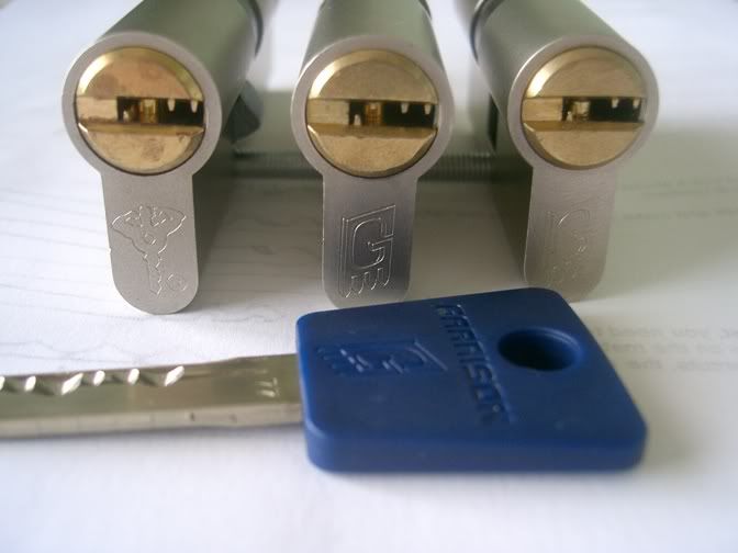

is it possible to impression the garrison cylinders?
notice the one on the left has the strongman logo and the other two have the garrison logo but all the same 7 pin locks

Providing the lock does not use telescopic pins, it CAN be impressioned. Drill all the holes down as deep as you can, then thin the blade of the key down a bit. Apply a layer of aluminium foil over the blade and carefully insert into the lock. Turn the key from left to right, and it'll open. Openings vary, but under a minute would be a decent time.

i have tried this illusion but if you look at the pic there is a ward to the left of the pins that the groove in the key runs,this ward just rips up the foil.

Ok, but the wards are actualy away from the pins, which means you should be able to get a strip thin enough to avoid the wards, but also provide enough surface area for the pins.
If kitchen foil is proving crummy, try using the stick-backed foil tape sold at Halfords. This stuff is sturdier than kitchen foil, and doesn't cost much.
Barring this, then either bumping, or using the Souber MTL picks would seem the best way.
