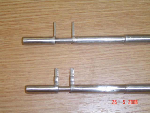

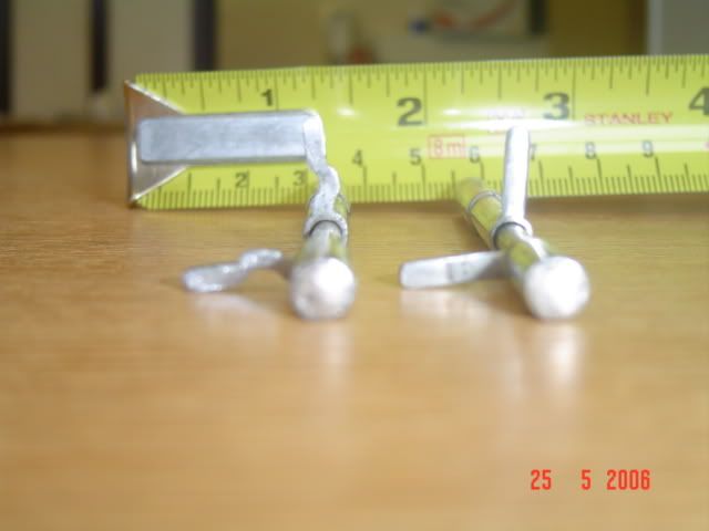

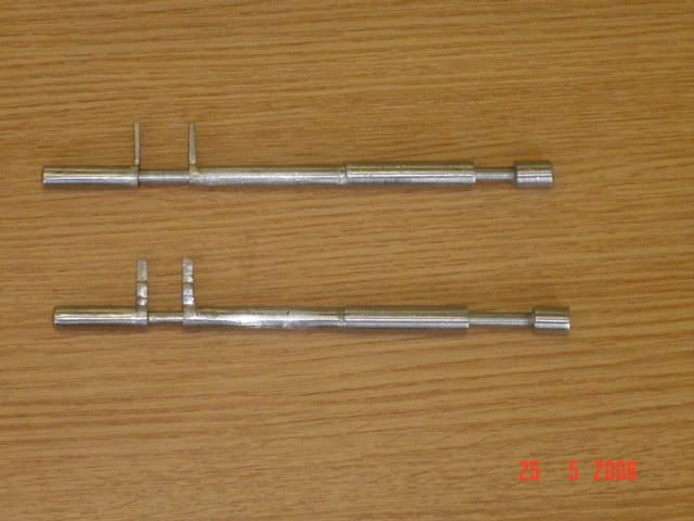

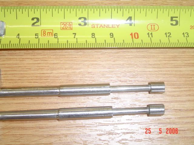

I’ve been looking for an excuse to put some pictures of my home made 2-in-1’s on and you just gave it to me. :lol:
The ones I made are 5G, as that’s what the 2 &3 lever locks I’ve got are. I could only get ¼” tube so that’s why you can see the lip halfway down the shaft.

The handles are secured, by tightening up the handle on the long one and a grub screw in the circular one. The idea is that they are interchangeable, so I only need one for all the picks I make.
I could do with making another handle as the plastic one’s a bit crap, but it works, they both need a bit of finishing with the old wet& dry as well
Oh and now I’ve had time to look at the pictures, I realise my use of the tape measure for scale wasn’t all it could have been, but I was in a rush using a borrowed camera so you’ll gust have to forgive me
Any comments welcome

Nice. Do you care to say what the material was, and the technique for joining the sideways pieces on. Silver soldering?

Postby Lukekjackson » 25 May 2006 17:25
The material is Stainless Steel, it took me about as long to find some suitable sizes in small lengths as it did to make it. :x
Yeah the legs are silver soldered on, made possible by shrubs guide, Thanks for that by the way shrub :D

Postby Lukekjackson » 26 May 2006 3:57
I know what you mean about getting the info you require, but to be fair to everyone, I think there is an issue with putting pictures of shop bought tools on here.
Hope this is what you were after; if I’ve missed anything let me know.
Overall Length -110 mm
Max leg separation - 25 mm
Outer Tube OD – 5.3 / 6.3mm
Inner Tube OD – 4.0 mm
Leg Length – 11 mm
When I made them I made the legs about 15mm then filed them down as required, I’d say the best bet is to make a few, with oversized “blanks” for the legs to be altered as required
