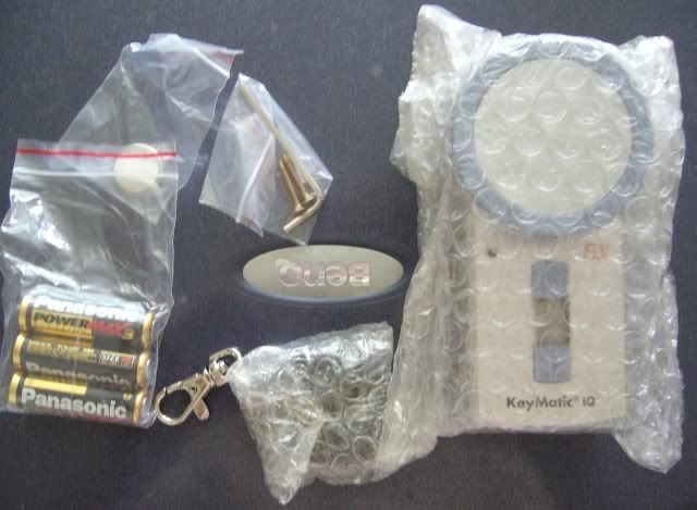

The folks at ELV mail-order are to be congratulated. Order submitted in the early morning hours of the 11th, and received today, roughly 40 hours later.
The Keymatic IQ+ included the driver device itself, the europrofile mounting bracket, one keyfob with attachment chain and two set of screws for mounting. Batteries for keyfob and device were also included. Manual is well written but I actually only needed it for the setup process, the installation itself is pretty straightforward.

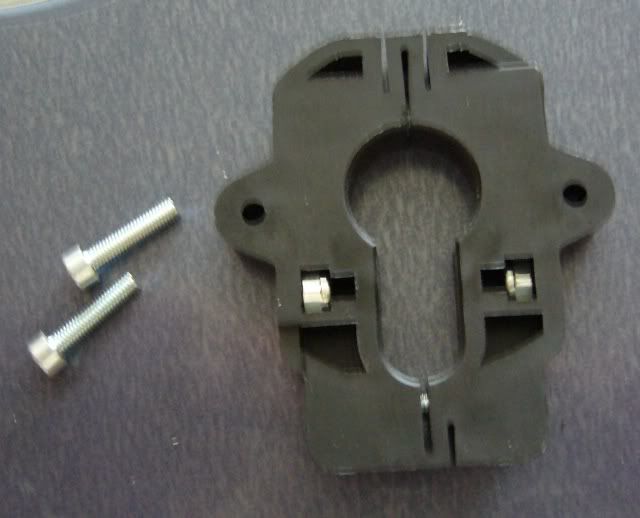

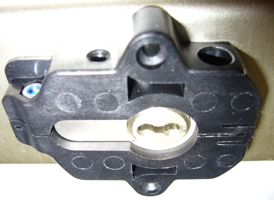

ELV suggests the cylinder to stand out 10mm on the inside, and the mounting bracket is exactly that deep. However, my calinder is sticking out merely 6mm and mounting the device was no problem. I'd even think you could get away with just 3-4mm, these would just be aligning the bracket properly, for added stability there is a set of two screws included that enable you to secure the bracket to the door itself. Those are wooden screws. In my case, the holes for these screws are still over the handle plate, so one could find differently threaded screws in the same diameter, put a small drill hole into the shield and secure the screws either by threading that hole or by countering with a nut if handle plate design allows this. One thing that should be checked is if the key (the round head part that is usually gripped with the fingers) is dimensioned in a way that still allows the engine to grab and turn the key properly without the rounding getting in the way. If it does it should be a quick job on a file, hacksaw or dremel to shape the key accordingly.

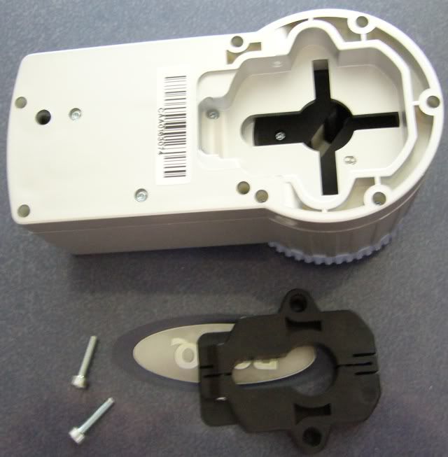

The device itself has a small little display that aids in the installation process. In operation it displays the state of the lock with a little symbol and also display the last access made. This is done by showing which unit was used to initiate the last operation (1..9, as there are 9 fobs max). Learned fobs can be removed, additional fobs added in very short time. The changing of learned fobs will ALWAYS require the first learned fob, the master fob. In case of loss or damage of that it is required to unscrew the device from the mounting bracket and push a recessed reset button in the housing to remove the fob data. This is basically "default to factory" as the rotating setup has to be repeated after that.

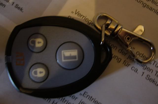

The fob has three options, lock, unlock and release. Lock and unlock will do just that, the release will unlock and turn the key even a bit further to pull the latch into the lock body and therefore automagically let the door pop open. Ons ome doors a short latch retraction might not do the trick of having the door open so you can optionally instruct the device to keep the latch retracted for full 2.5 seconds. Even if your door does not swing ajar by that time, it is still long enough to tap the door with your foot if you are coming home loaded with grocery bags. There is also a small LED on the fob. The buttons on the fob have to be pressed down for about a sec before the driver gets into action, this is a good safety measure against accidental operation when putting the fob into your pocket.

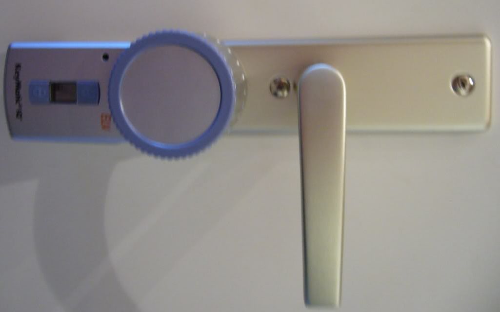

Operation of the lock from the inside can be done by either pushing one of the keys on the device to lock or unlock the door. To save battery lifetime the lock can also be operated by the wheel.

Contents of the kit

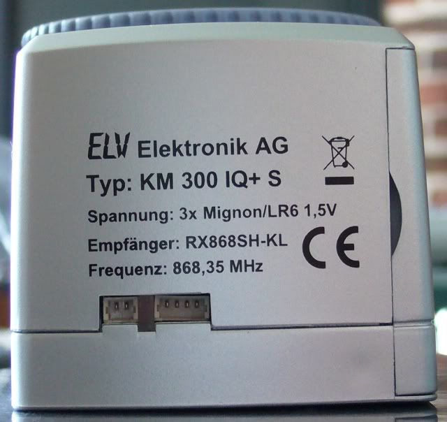

Business side of driving device
Bottom of device with LED/power supply (optional stuff) connectors
Mounting clamp alone...
...and mounted to cylinder
Device mounted and ready to roll...
Closeup of keyfob
