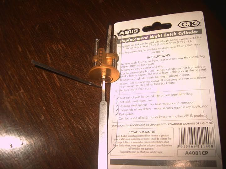

I got my first set of picks the other day. I went for the Southord 8pc set. After a hour i was managing to open 3 cheap padlocks quite consistantly so bought this as i thought it would be a bit more of a challenge. It only took a few minutes and it was open! Last night i dismantled the lock but didnt find any mushroom pins like it said on the packaging but a steel first pin and 4 spool pins! Surely this is false advertising? I was thinking of repinning the lock but where could i get extra pins?

Abus have been describing their spool pins as mushroom pins(Pilzkopfstiften) for years. At first it disturbed me but I guess that it's just a question of terminology. After all, each end of a spool pin looks like a mushroom. I would have thought that the action is the same in each case, and spool pins have the manufacturing advantage that you can put them in either way round.
As to why you found that one specially easy? Dunno.

thanks for that keyring, is it possible to use pins from a different brand of lock to repin?

Postby iNtago » 3 Jan 2007 14:29
i dont think so unless a locksmith/DIYer repined it before you got it
some how pins are put in randomly so that might be why

As for repining, im not sure how good an idea it is but i interchange pins between this type of lock (Yales) and euro cylinders. seems to work fine.

i just put the lock back together again but intentionally mixed the bottom pins. i put the longest pin first to make it a bit harder. i might go up to focus in the morning and buy a euro lock to practice on and maybe swap pins about.

Some people call them mushroom pins some call them spools, there is such a large variety of security pins that it is a common reference to just call them by these two names.

Pins are generally interchangeable, thats what LAB built their business on, though some locks have their own pin sizes, never throw out a lock before salvaging parts like pins, springs, tailpieces, etc.
To make your ABUS harder to pick, you could replace the springs with some strong springs, such as are often found on euro cylinders, also euro cylinders may have thicker pins. Im not sure if this just the euros that I have seen or if its generally true.
