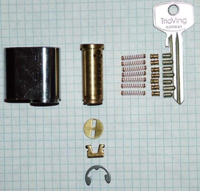

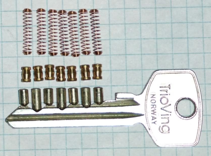

by JackNco » 8 Feb 2007 16:34
some nice EVIL looking spools there. 7 pins as well have u managed to open this up yet?

by cjames73 » 8 Feb 2007 17:32
that looks so hard to pick. 7 spools and awkward bitting.
ive got to get one

by What » 8 Feb 2007 19:56
good job on the breakdown, but a picture of the keyway would be nice...

Hi net-rom, it's nice to see the scandinavian cylinders you post about
It is probably a TV 5537 (TV 5520 is similar, just with a different 'mount'). The 6-pin version is available for 'home' use, and the 7-pin is used in master-keyed systems, or "systems" as TrioVing calls it.

nice lock ! looks like a model you can pick . . . mine is still a littel to hard (for me) but it will come.

It looks like these security pins are designed to fool the person attempting to pick it by making it appear that you have bypassed the spool pin when all you really did was just push the center bulge past the shear line. I want one!
