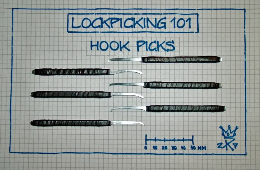

This is some of my home made hook picks
Materials: plumbing snake (a cheap one 2 Dollars for 4 meters)
Tools: cheap dremel copy with cutting blade ( 14 Dollars)
cheap key file Set (2 Dollars)
sandpaper P240 and P400
most of the work was done with the dremel copy and then fine tuned with the files and sandpaper.
It takes me 2 houres to make one pick form start to finish.

Postby cjames73 » 14 Feb 2007 18:07
nice picks!
i like the way you displayed them too :D
so what are they like to use?

Postby net-rom » 14 Feb 2007 18:18
they works fine . . . i got 2 small sets a dino and a southord . . .but i find that it is the home made picks that i use moste (all moste 100% of the time)! by the way i forgot to tell that the handels are made form electrical tape this gives a nice grib and are cheap to replace .

Postby Tygart » 14 Feb 2007 21:21
They Look good, Do they make good dimond and Ball picks?? And what about wrenches?

Postby iNtago » 14 Feb 2007 21:25
the tangs look a bit wide but all in all some awesome picks :wink:

Postby net-rom » 17 Feb 2007 9:44
"Tygart
PostPosted: Thu Feb 15, 2007 10:21 am Post subject: Reply with quote
They Look good, Do they make good dimond and Ball picks?? And what about wrenches?"
net-rom
i have made som good diamond picks and it is ok for wrenches ( a bit thin, but it works) and ther is a spring in the end ther makes a nice feather touch wrench !
I will poste som pic, but i will just finish my ball, snowman and half ball picks first so i can take pic of it all in one take ! :D
