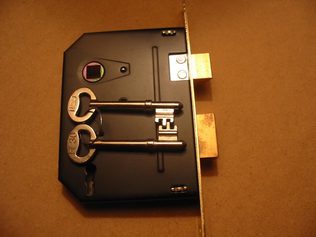

Postby keyman » 17 Apr 2007 13:40
just found this pic on another post about canadian lever locks
http://i152.photobucket.com/albums/s189/moosehead_photo/Picture001-2.jpg

Postby keyman » 17 Apr 2007 13:53
Your right there shrub the only time i have ever had to name all the parts in a lever lock was when i took the enterance exam ,i can't remember the last time i ordered a lock without the stock code ,anyway there are a few good sites on here that you can get all the info but to read chubbs the history of locks you need a feew spare hours , there is a union 2 lever lock ,which has 24 differs but has 4 different bullet wards so making intotal 96 differs or to the lay man keys ,but without saying to much in an open forum you only need 6 keys to open all
