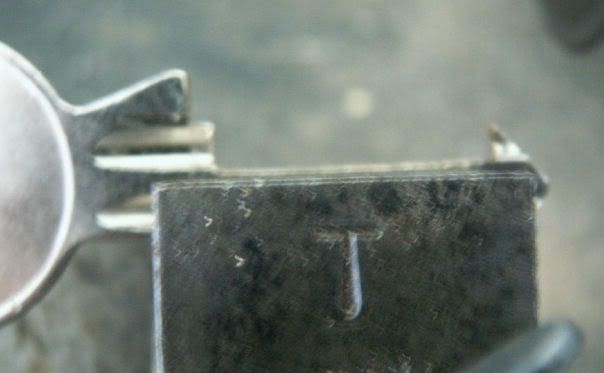

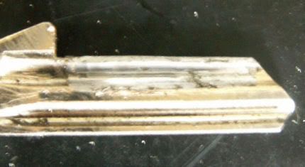

Postby cjames73 » 19 May 2007 10:14
you can use a piece of lead as an insert on a blank key.
first you need to cut out a section below the deepest cut for that particular lock.
then you need to solder the lead into the key,
now you have to file the lead to fit the warding.
use the original warding at the beginning and end of the blank as a guide.

Postby raimundo » 19 May 2007 10:30
if you do it as cjames said, file a stick of chalk one stroke between every stroke of the file into the lead, this will help when you try to file card that lead out of there. file the chalk first, this will fill the tight little depths of the teeth with a loose material that will not stick. then the lead will not be so able to permanently fill the file.
