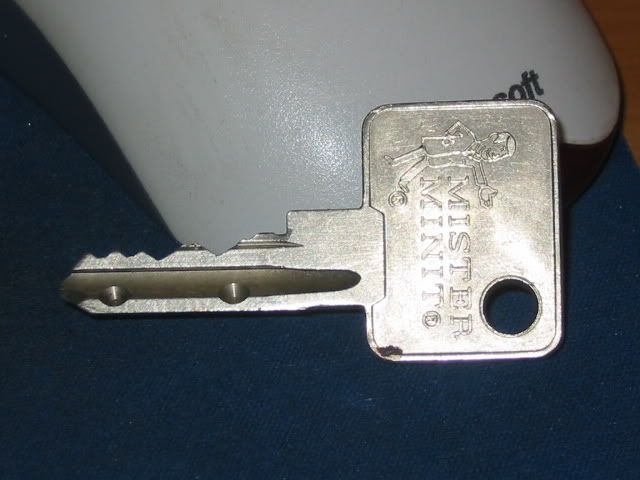

Postby LockNewbie21 » 1 Jun 2007 15:44
Yes that correct, the brass and chrome are booth of diffrent sizes.
There completely passive, however, if you snp gun the lock which i do form time to time just for the kec of it, and you contact on of these, th can be pushed or moved with a hook freeing the cylinder.
The tough part was I mixed up one passive pin, and it cost me the lock, I had to cutit open trying to not damage the plug not pins (Pssive and active).
And the passive pin jammed itself in the plug, and the key is still stuck I let it in there as a reminder.. Take my time with winkhaus's.
