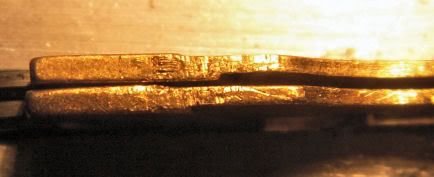

next time you get one have a look at the levers to see if there are any marks from a wire pick.
these levers are from my very first attempt at picking lever locks so maybe your locks will be similar.
