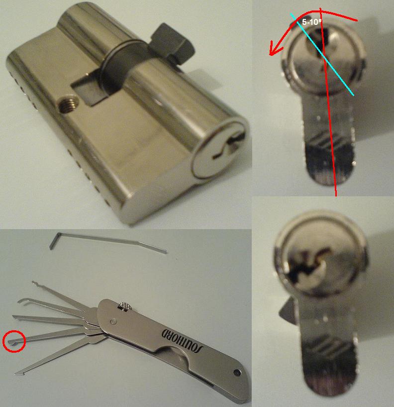

Hi mates,
As starter conventional key cylinders are my prime subject.
I analyse CISA 087 series cylinder
http://www.cisa.com/flex/cm/pages/ServeBLOB.php/L/EN/IDPagina/2051
I have no result with half diamond and snake pick so I decide to try with half ball.
It`s well-know that half ball is using for picking wafer locks, but despite that I try it and I was astonish.
I placed half ball pick approximately 5-10 degree at most anti-clockwise and strong rake 3-4 times until I feel that pins was jammed,
after that I align pick and rake softly several times more and cylinder was picked.
This kind of picking take 10-20 second at the most and works all the time.
I know that best approach is the one which open the cylinder, but is this common one?

Postby zikmik » 11 Dec 2007 5:33
Hi again,
I improve my half ball picking method and now on I need around 5 second to open any side of cylinder in any direction.
The thing that confuse me is that I need much more time to open with other picks.
Half Ball around 5sec
Snake pick 10-15sec
Half Diamond max 20sec
Hook pick more than 30sec
Can someone confirm this by raking same cylinder with different picks?

Postby Fredmad » 12 Dec 2007 2:35
The Cisa cylinder is normally built with diabolo drivers. That is the reason why when you pick it the core turns a little. That means that all the normal drivers are in right position and the diabolo pins lock in the shear line.
You can find 2 different kind of Cisa with the same keyway:
- one with 6 cuts
- one with 9 cuts
A 9 cuts with 4 diabolo drivers with lowest cuts near near highest cut is more difficult to pick than a 6 cuts with 1 or 2 diabolo drivers.
I don't know if you know that Cisa is the same cylinder that Abus first price and Abus C83.

Postby zikmik » 12 Dec 2007 4:10
Maybe for my bad english I was misunderstood,
When I start this topic I test half ball on CISA but since I am from eastern Europe
I try to pick ELZETT and result are the same, half ball is faster...
Conventional EURO key cylinders are lower quality but most commonly used so I chose it.
I need to find out is half ball pick, commonly use for wafer locks, can faster pick then snake or half diamond?
I agree with Eyes_Only but use your favorite euro cylinder and try to pick with half ball and tell me the result.
