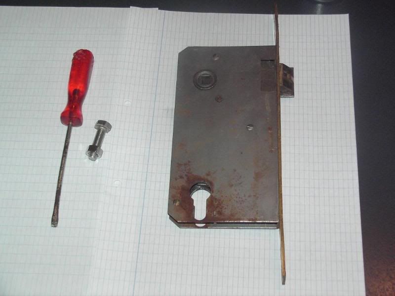

Today we are going to take apart a Mortise Euro cylinder lock.
For this we are going to need
A lock (Meco in this case)
A screwdriver
A bolt , washer and nut. Usually a M8

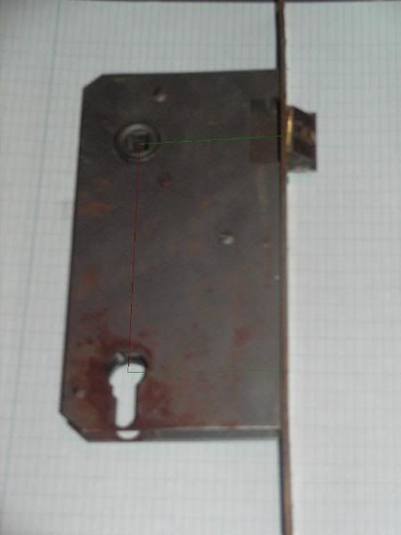

The most important thing to know is the locks Backset. Its show in the picture as the green line. This is the distance from the center of the cylinder hole or door handle spindle to the face plate. This goes from 20mm to around 90mm in my area. With the exception of some KFV locks on 24mm , locks usually step in 5mm. Most common in my area is 55mm,
The next important thing is the Center distance. Its shown in the picture as the red line. This is the distance from the center of the cylinder hole to the center of the door handle spindle hole. This depends on the country the lock was produced in. Holland uses 55mm , France 70 , Germany 72 and 92 , Italy uses 85 and Belgium uses 110mm.
There is a reason why the backset is more important than center distance. Sometimes , a lock is no longer made and no locks can be found with a matching center distance and backset. Its easier to use another lock with the same backset and drill a new hole for the door handle , than it would be to use a lock with the same center distance and drill new holes in the door for the door handle and the cylinder.
Also very important is if the lock is Left or Right. The best way to know is to look at it from the top with the latch away from you. The angled side of the latch shows this is a DIN Right lock. Note that some countries don't follow the DIN rules. In Belgium , this would be considered a Left lock.

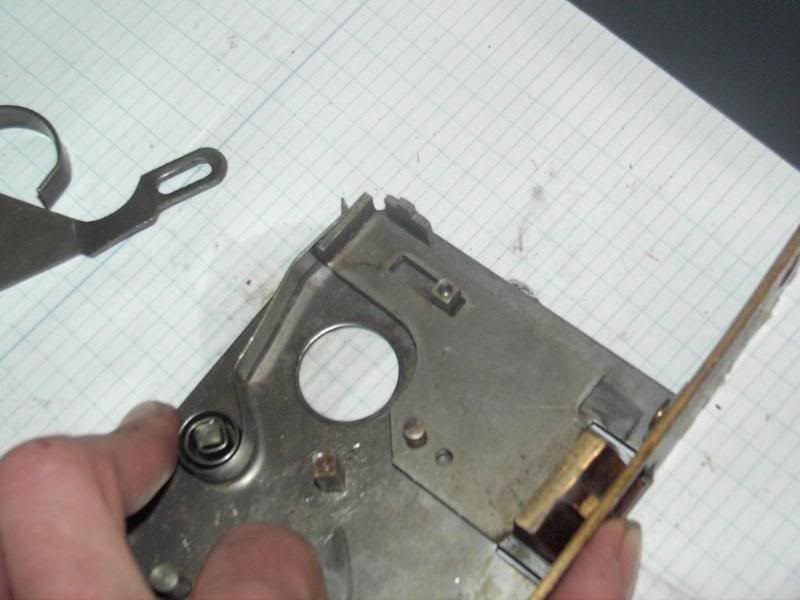

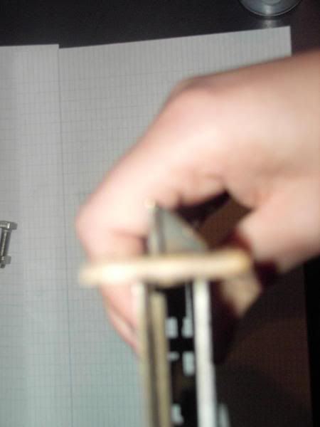

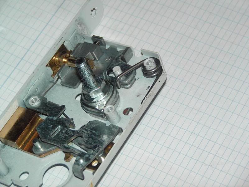

Before we open the lock , here's a little trick to prevent part from flying around everywhere. An 8mm bolt is run from the back of the lock trough the spindle hole and attached with a nut at the front. A lot of parts for the latch are spring loaded. When the lock case cover is removed , these parts will fly out of the lock. The bolt prevent that from happening. It also makes it easier to reinstall everything.

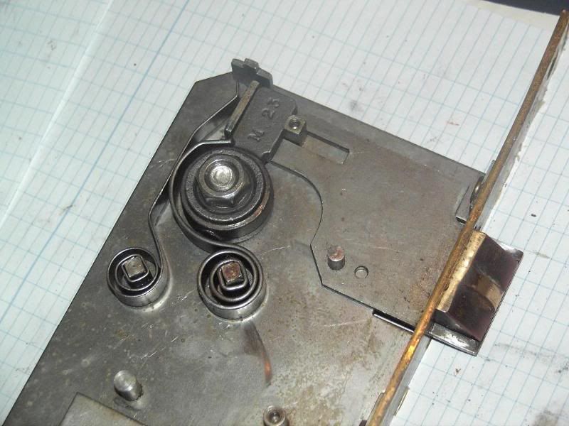

Here are the internals of the lock. Only the cover has been removed.

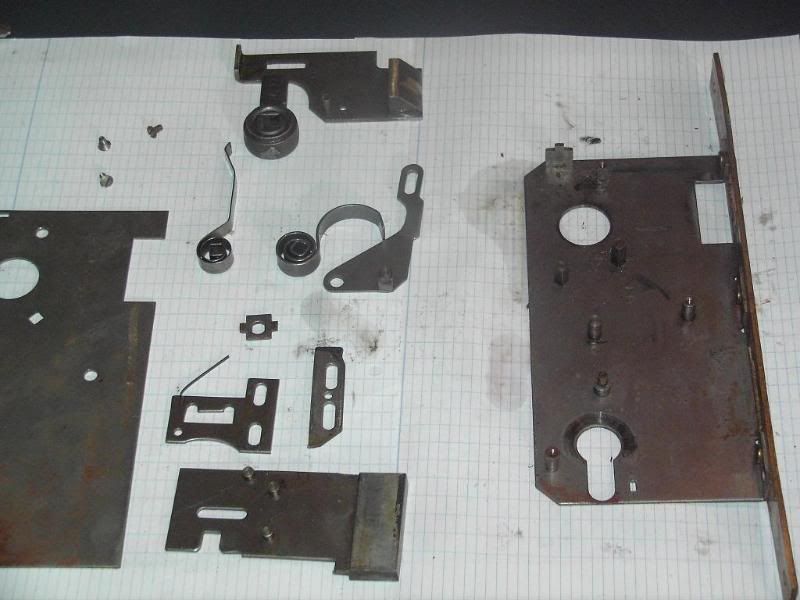

And these are all the parts disassembled. In a modern lock , there will be a lot more parts. Some features like reversible latch and double throw deadbolt add a quite few parts.

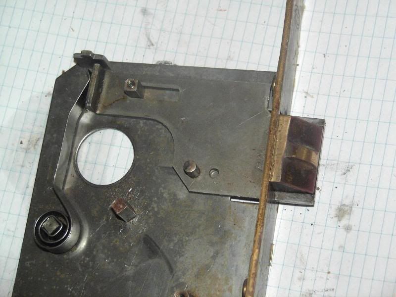

In this pic the deadbolt is reinstalled. Here it is in the unlocked position.
Here I've installed a Euro cylinder so you can see how the follower locks the deadbolt. Also , note the little part on the screw. This part is often lost when a lock is taken apart , or it isn't reinstalled properly.
The next part is basically the same as a lever in a lever lock. Its lifted by the follower of the cylinder. It locks the deadbolt in either the open or locked position.
Thats all the parts involved in the deadbolt.

This is the latch and its spring.
The latch holds the door shut. It is pushed in by the door frame when the door is closed. It can also be pushed in by hand

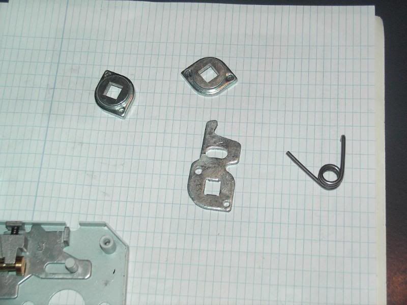

The next part is the spindle square and its spring. In the first pic I've only installed the spindle square itself. Then I've installed the spring after I placed the bolt and nut again. This makes it much easier to put the lock together again.

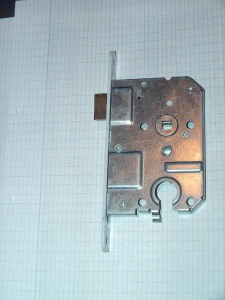

This time its a Nemef.

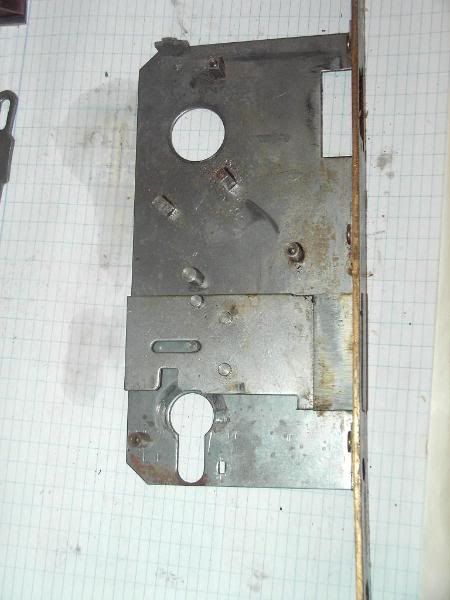

This is the lock itself.

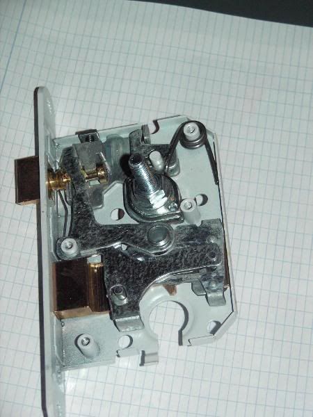

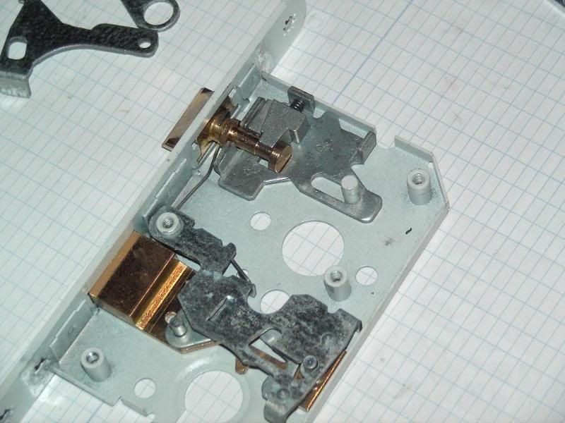

This is the same lock without the case cover

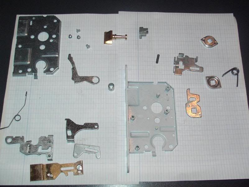

And the internals , all taken out

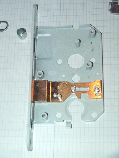

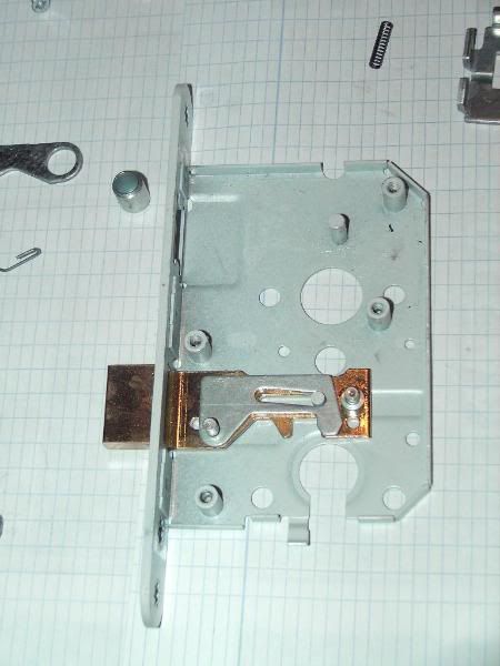

This is the deadbolt in this lock
And a little guidance piece
This part takes the role of the lever in older locks
Also , note the spring on the back of the faceplate
This is the latch
As you can see 3 pictures ago , the latch carrier is made of 2 components and a spring. This allow the latch to be used for both Left and Right hand doors.
The spring for the latch is the same as the one holding the deadbolt locked

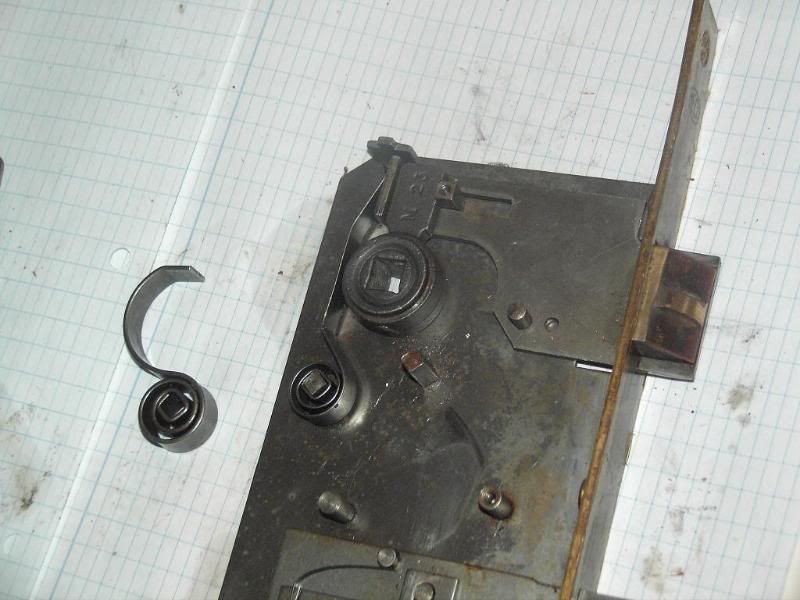

These components are for the spindle square. On the Meco , this was 1 solid bit.
With those parts and the spring reinstalled , the lock is complete again.

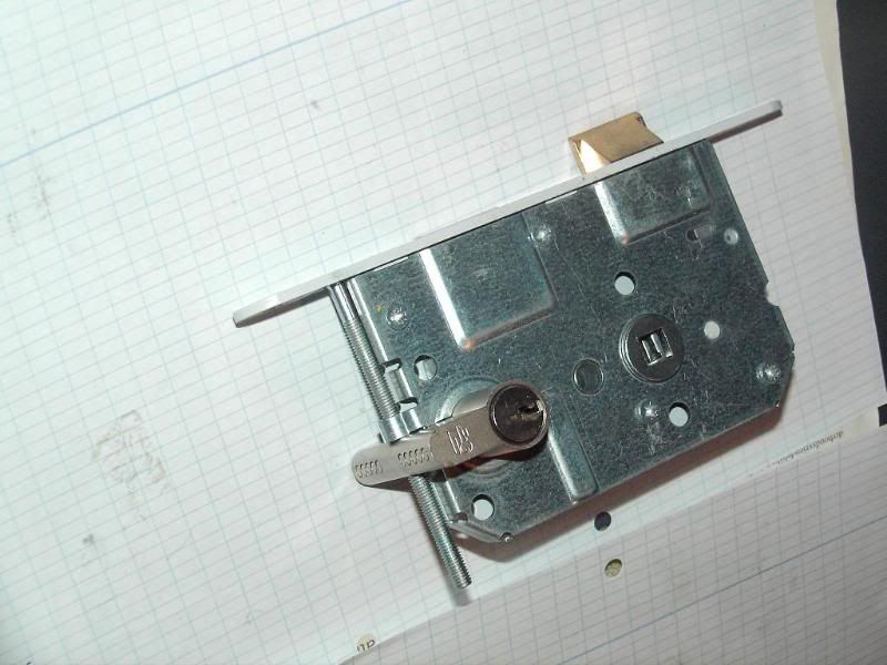

For those of you who are curious , this is what it looks like with a cylinder installed.
I know , its a wierd angle. But thats the only way I could get my camera to focus properly.
