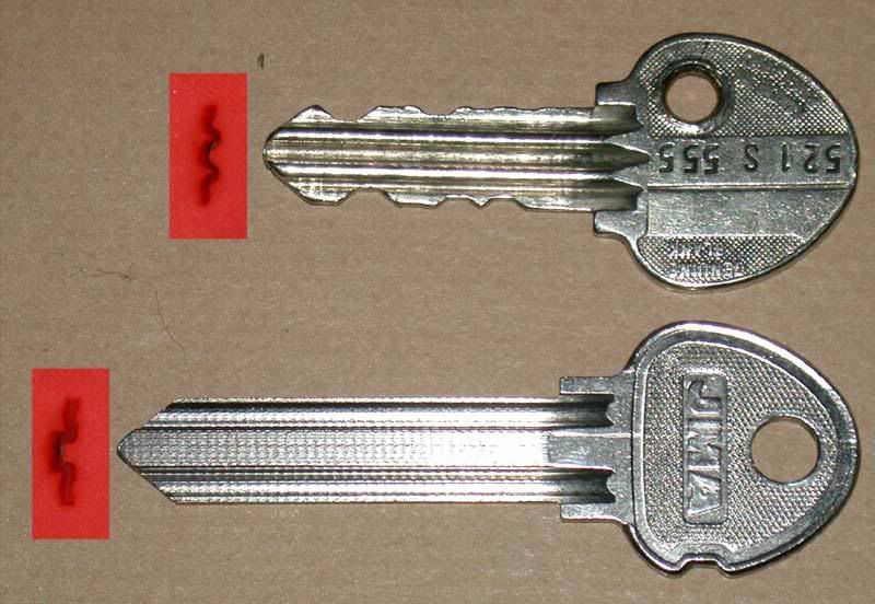

Just to check - are you 100% certain it isn't an A M or S profile?
There is another ingersol blank I've seen on occasion, which a similar head shape but a longer profiled section. I'll see if I can get you a picture.

Postby aussielocky » 28 Jan 2009 17:29
There are also M & W profiles ..

Postby mhole » 30 Jan 2009 17:50
True dat...
Here's the one I was thinking of, next to an S section for size comparison. It's a JMA ING-D.

Heres the blanks I have from the shop;
JMA ING A
JMA ING S
JMA ING W
HD IG5 - Has "security procedures apply when duplicating"
SILCA ING6
And of course you have the Military keyways plus a few custom made keyways out there.
