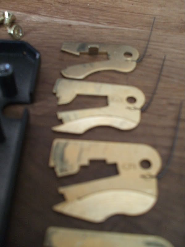

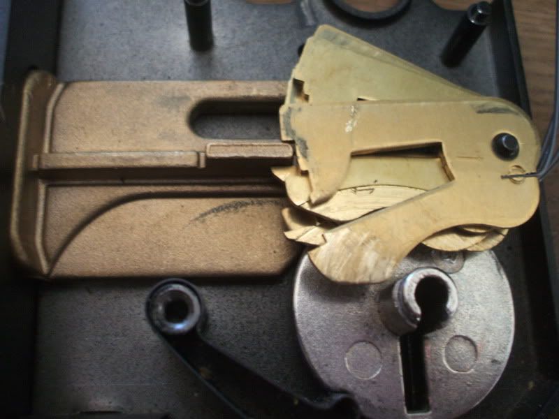

Postby Rickthepick » 2 Nov 2009 6:31
sorry took so long to get the pic's up
as you can see back lever is already open to the bolt stump and has a folded lip on the underside to disrupt 2 other levers when touched. It does not align them correctly as i thought it might.
3rd lever has a cutout in the gateway which is unusual
The only reason i can come up with for this design is so that the 3rd lever can sit extra low in the lock as it hangs on the folded piece of the back lever.
all other levers are normal securefast nothing unusual
any ideas?

Postby pixel » 2 Nov 2009 12:40
If you only lift the back lever with the lip, does it lift all the other lever gates to the stump?
Are all the other components, curtain, bolt and casings exactly the same as a normal Securefast?

Postby Rickthepick » 2 Nov 2009 16:58
no it does not align the levers :|
exactly the same as a new non bs securefast black

Postby pixel » 3 Nov 2009 6:51
Just spoke to Securefast, and it's master keyed.

Postby Rickthepick » 3 Nov 2009 7:26
hmmm seems i made a mistake.
the back lever does align the 3 in front of it. (im pretty sure it didnt last time i looked) :lol:
the front lever is not affected
i still cant fathom how this work work with other locks in a master keyed set though
In theory this should be a very simple pick but the back 4 levers dont bind with the lifting of the back lever. Still a moderately easy pick though
