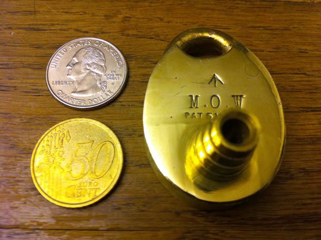

Wow... mine just arrived in the mail today. I didn't realize how small these are! :lol:
