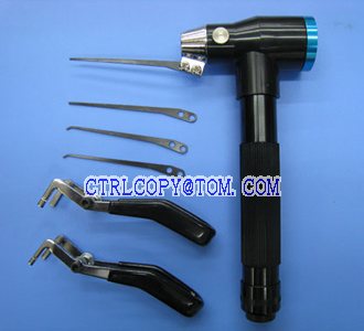

You noted that you would like a scope? I have this Image http://keymam.com/product_view.asp?pid=1212 and use it a lot. Price is approx 45USD+shipping.
