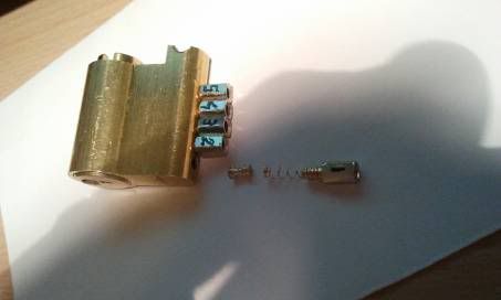

Now put the cylinder back in place,drop the driver pins (spool or whatever) in the holes and close the holes with the modified spacers:
(I wrote numbers on them to remember the order in which they fit with each other)
remember to replace the circlip.

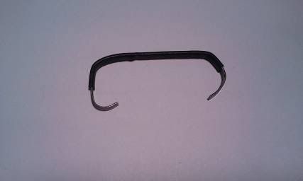

To hold the spacers in place I took a piece of street bristle and curled it like this:
and used a piece of heat-shrink tubing for a better look.
