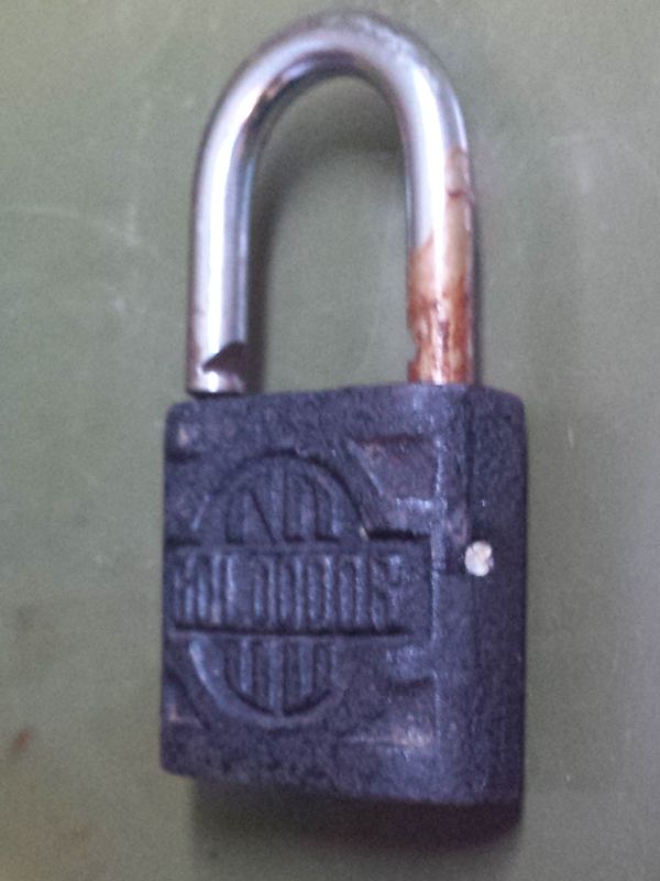

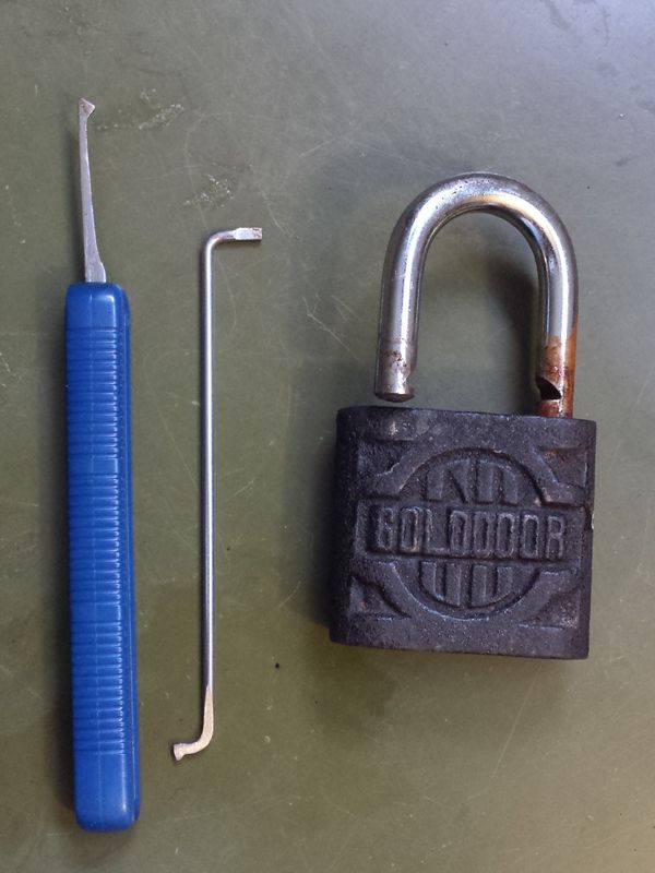

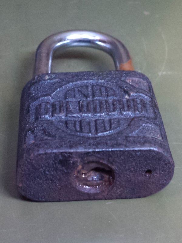

The first one is a cast iron Golddoor 4505, locked without a key and pretty rusted. Both the shackle and the plug were blocked by the rust and I had to spray it with penetrating oil to be able to move the shackle a little in and out. The plug was still a solid piece with the body. I decided to let it soak in a coke can overnight and then rinsed and dried with compressed air. I forced a bit with a screwdriver... It was not enough so I heated it a little with a torch... the plug started to move! I then picked it and finally opened this poor old lock that may have been locked for years before my unusual intervention.
Here you can see the plug retaining cap and pins caps.

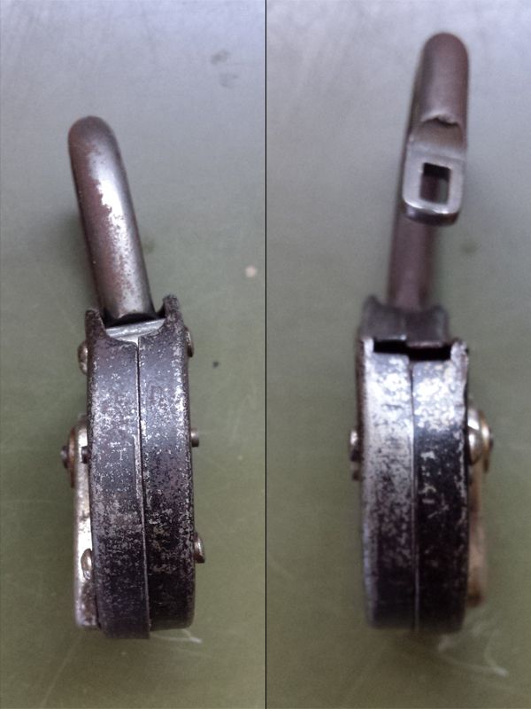

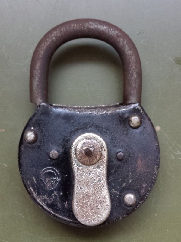

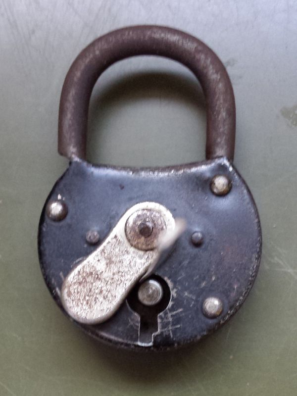

The other one is an unknown brand lever lock made in Germany, opened but without a key. The logo on the front looks like a big padlock with a tiny keyhole on the bottom and a big W over it. Any idea about the brand?
I plan to make a key for it but dunno if it still works. As you can see in the last picture it's ruined. Looks like it was run over by a truck or something very heavy, the rivets were bent and the body warped. Still a nice lock to have.
