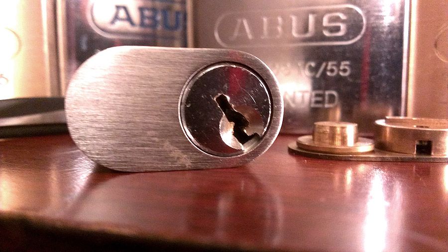

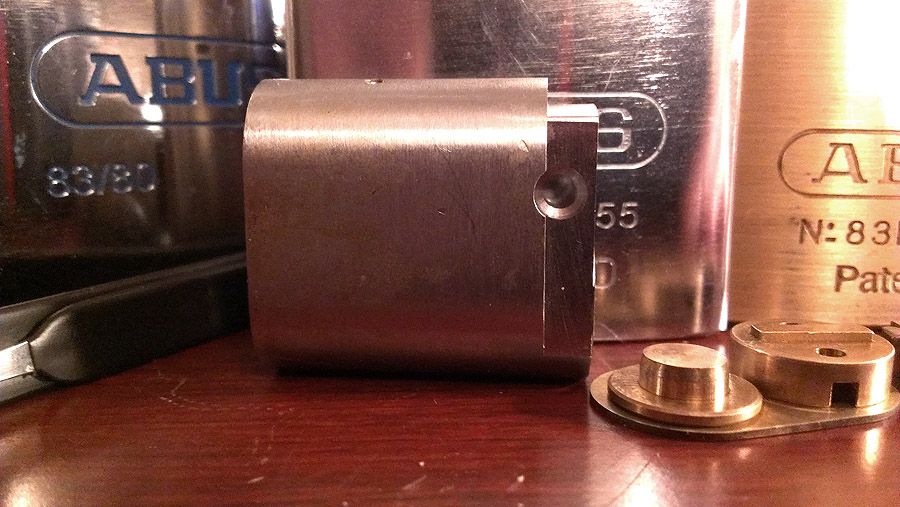

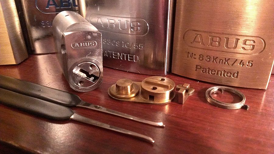

I recently purchased a lot of Abus 83 padlocks on ebay, 2 of which are 83/80's that Abus's website says uses Scandinavian Oval cylinders. Well I picked them open and removed the cylinders but, they didn't appear to look like the Scandinavian. I did some searching around on Google and it seems they might be actually be Australian Oval Cylinders. Looking at Abus's site it is an identical match to their 570 oval cylinder.
I am hoping to obtain some key blanks for these cylinders so I can re-pin them as the pins that were in them are identical to the ones I took out of the Schlage cylinders from my other 83's, just different springs. I am hoping one of you might have some experience with these and might better know what key I need and where to obtain them at. It is a 6 pin cylinder.
Looking through Ilco catalogs there are quite a few that look close such as (key blank codes are from Ilco's catalog not sure of actual name for them) Lockwood LK1, Whitco WO2 and Gainsborough GR7 which are Australian keys but, also Kwikset has some that are really close as well. Kwikset's KW1 fits the lock but the fit is sloppy and is also only 5 pins rather than 6.
Here are some pictures of the cylinder so hopefully someone can help me narrow things down.

P.S. - that IS a Schlage SC1 keyway on a Scandinavian Oval cylinder. He is just showing the back end of the cylinder, not where the key enters.

But ok, back on topic, The SC1 is of course facing the wrong direction but, even trying to insert it from the back, the shape is way off. Like I said the KW1 fits, it's just very sloppy and to short. The warding is just a bit off in the center of the keyway.

Op is correct, not Scandinavian oval, probably as Australian. I've only ever seen that format on Australian bi lock culls before.

Silca ref is LW4 (or LW5 if 6 pin). Aussie 570 pattern for sure.
I have code cut keys if you wish to repin or blanks if you cannot source elsewhere.
