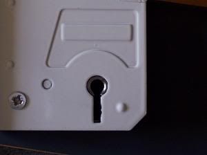

1. Colour of case
From looking through the keyhole with a *white* light (needs to be white - no other colour will do) you will see a colour. This is not always fool proof.
It is a good starter but some manufacturers produce locks for other companies or people paint their locks to confound entry methods.
Look for flakes of paint as keyholes tend to rust quickly!

Pinky I hope you noticed the black plastecine on the right of the keyway on the legge!! another easy victim! :D
Happy picking!
Sidpick :D

Postby pinky » 8 Feb 2005 17:43
should be an easy victim as only a 3 lever lock if the new legge 3 lever, pin and cam just loves them to bits.

Postby sidpick » 8 Feb 2005 18:25
I like the big fat impression given by the spacer! this one had a code which included a 2 and 3! so literally seconds to open :D wont be having them fitted on my doors!
