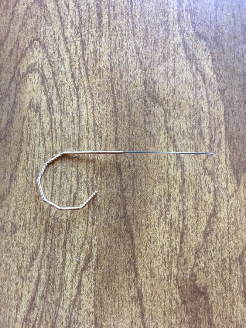

Postby GWiens2001 » 19 Feb 2017 16:22
My favorite one is a guitar string that I bent the tip back to form a hook.

Postby GWiens2001 » 23 Feb 2017 19:37
I usually use the D string, and peel off the winding, leaving an area on the handle area of the extractor.

Re: improvised extractor?
Postby GWiens2001 » 2 Mar 2017 19:34
This is a similar tool to my extractor. I use this one for measuring the gates on a push key lever lock. To make it an extractor, just make the end fold more than the 90 degrees.
As for how to unwind it - I just use tiny pliers or wire cutters to grab the bronze winding and pull.
