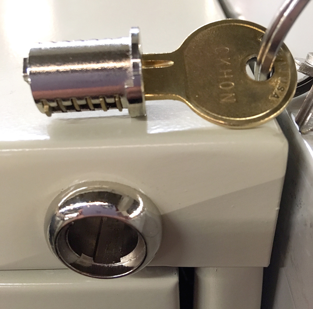

I have seen wafer locks where the cylinder is actually held in by an additional wafer that the KEY cannot reach. Which means under normal use, the key never touches that wafer and the cylinder never comes out; but when you're picking it you could go too deep, you could hit that retaining wafer and pull the whole cylinder out.
It's not a design defect, as it's made that way intentionally...I feel like it's just a huge security flaw, personally.

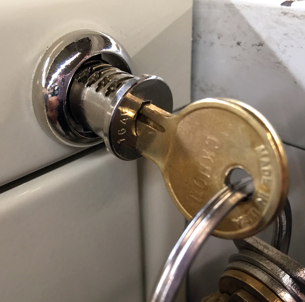

Silverado wrote:I have seen wafer locks where the cylinder is actually held in by an additional wafer that the KEY cannot reach. Which means under normal use, the key never touches that wafer and the cylinder never comes out; but when you're picking it you could go too deep, you could hit that retaining wafer and pull the whole cylinder out.
Many (most?) locks on a particularly popular brand of office furnishings are made this way. You can get keys that are longer than the standard blank designed to reach this retaining wafer in the back, and pull the plug out and install a new one for quick rekeying. Very similar to how the Schlage LFICs work (though of course, not anywhere near the quality).

They are made that way so maintenance, or whoever, can rekey office furniture very quickly with a special key and a new core. Steelcase, and now Hon, and maybe others are doing it now. Consumers may think it is more convenient than having to order a new lock or calling out a locksmith to impression a lock with a missing key, and it makes it easy to have one key for all of the furniture assigned to one employee, but that convenience comes at a price. It goes with the trend of putting employees in big open offices and then shuffling them around from team to team such that they have no office door to lock and they change desks every couple of months.
The issue is not that the plug comes out in picking, the big vulnerability is that anyone can order the special key and have a master key to every furniture lock in an office. But since wafer locks are so easy to pick it may not be much of an issue, really.

So when picking a wafer lock, if I just picked the retaining pin and took the core out, that would get me into the lock without worrying about the rest of the wafers? If so, would you tension it the normal way or as your end goal is to remover the core, pull on it instead of turning it?

It depends on how it's set up. The ones I experienced, it was possible to reach back and move that retaining wafer and just pull out on the core. No tension needed.
I imagine there are some out there that have channels for all the other wafers as well, so that the proper key has to be in to set all the wafers AND activate the retaining wafer. Without knowing exactly how yours works I personally couldn't tell you.

The change key for HON will only allow you to remove the core when it is in the unlocked position. If the lock is locked it will not let you unlock it or remove the core. It does not function as a master key. A regular HON key has 5 cuts, the change key has 6.
