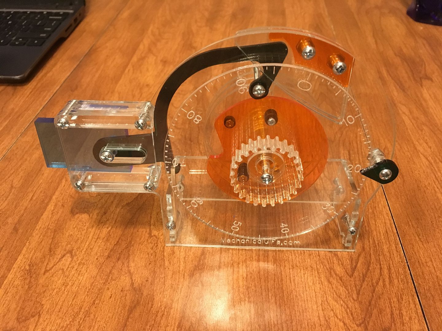

Well, it is assembled. :)
One suggestion if you make this lock - sand and polish the nose of the lever and the outer edge of the drive cam before assembly. If you look closely at the parts when you have them, you can see they are laser cut - meaning there are a bunch of ridges. It makes a loud groaning sound when you turn the dial. Took out the lever and polished the nose on mine to greatly reduce the noise. Don't feel like taking the whole thing apart again to get the drive cam tonight to silence it the rest of the way, so it will wait for another day.
Maybe I'll take a pic tomorrow in the sunlight so you can see the nice colors. The light right now makes this thing look a lot darker than it really is.
Re: 27 sec. video of how a combo lock works
Postby GWiens2001 » 23 Apr 2018 22:56
I'm too lazy. Here it is with a better background. :mrgreen:

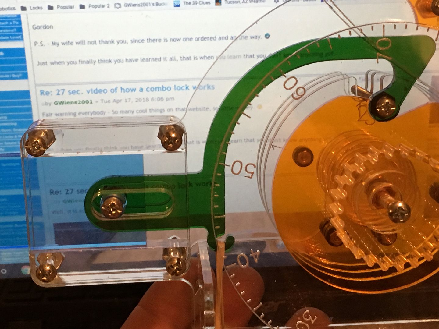

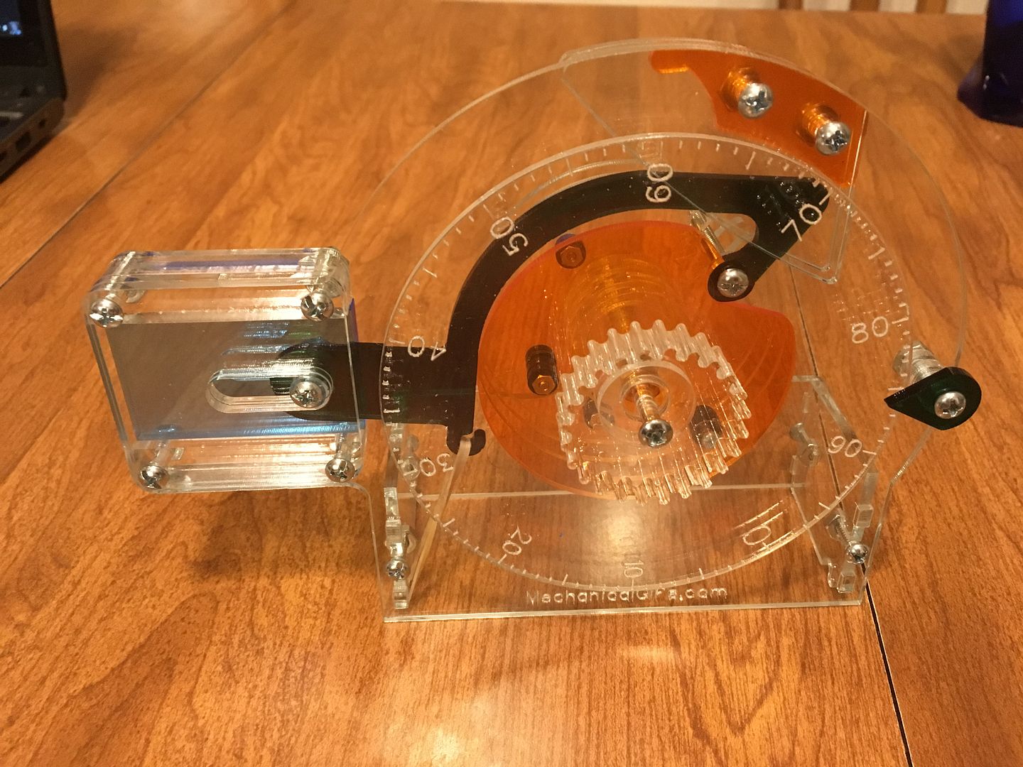

Postby GWiens2001 » 24 Apr 2018 20:13
Here is the lock as seen on the window sill from our dining room window. You can see the colors better.
And for size comparison, here it is on top of a mounted S&G 6730.
