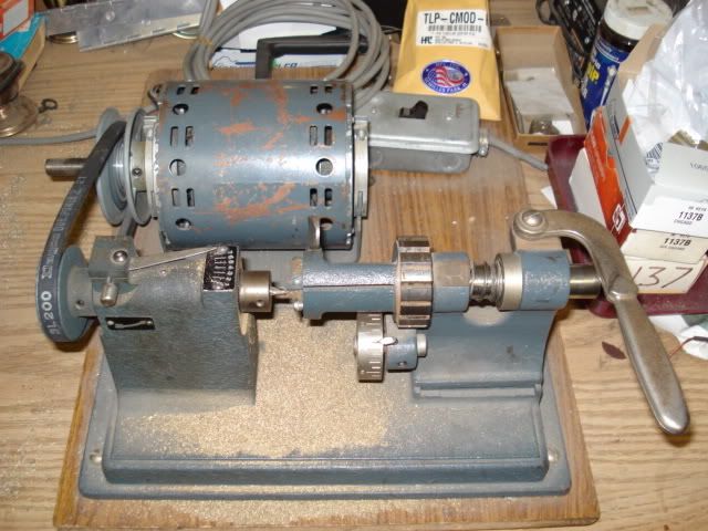

We have a Scottsman machine which cuts 3 sizes of tubular keys; standard, small and large;
And this machine, which I use most of the time but don't remember off hand who made it.
It cuts only 7 pin center. left & right cuts:
