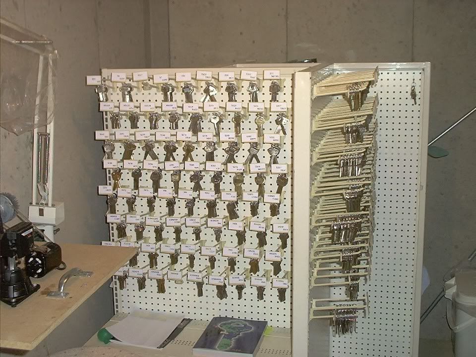

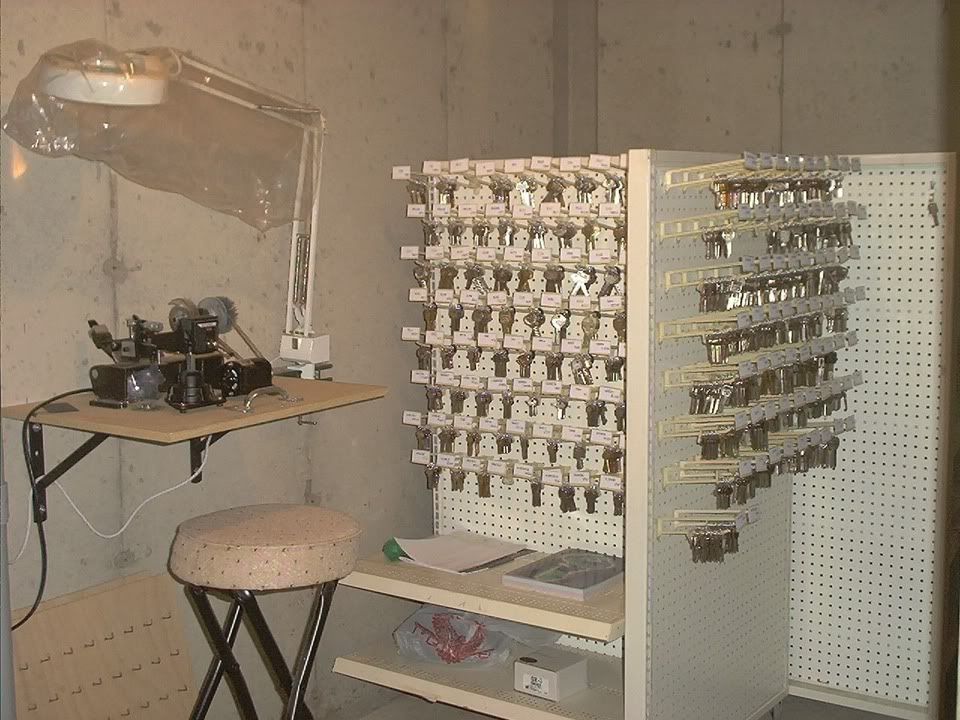

My fleet of NR2003 online race cars.

Buggs why is your key machine facing the wall? :P
Is it to hide the "Foley-Belsaw" sticker on the front? :D
(Just kidding, I have a model 200 F-B.)

Postby Buggs41 » 2 Jan 2007 7:21
I have it, and a Dremel swivel vise mounted on a board. I must have been working with the vise earlier that day, and never turned the board around.
