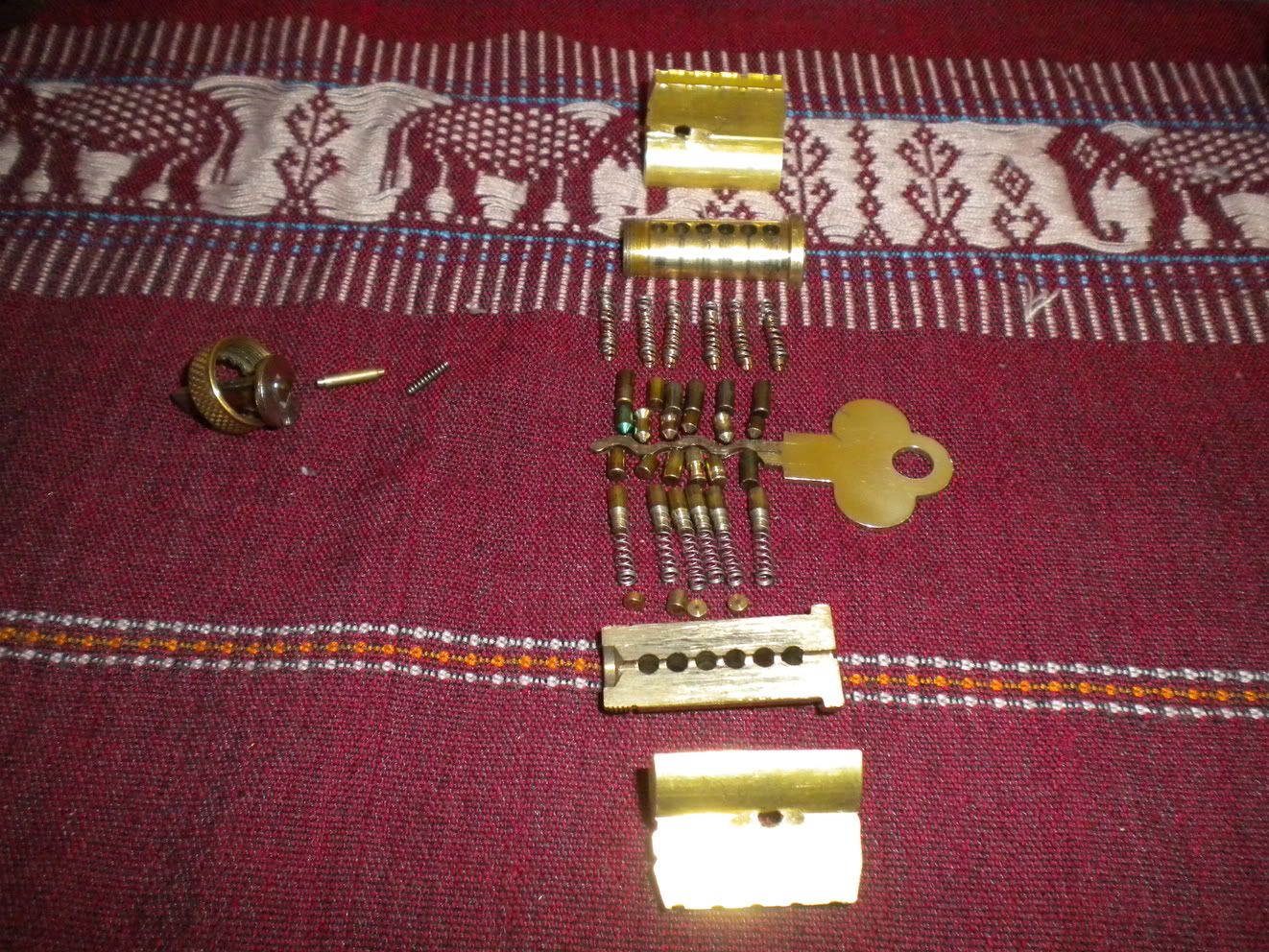

I felt that this lock was worth re-posting since all the topics disappeared. I have made a few modifications and will give a better explanation of the security weakness it has.
And here is a link to all of it's inner workings.
http://i669.photobucket.com/albums/vv59 ... 25/029.jpg

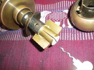

It has two springs on one side so the pins always stay seated on the opposing side. It also has master pins on the opposite side of certain springs. this is to make the pins in those chambers stop before moving past the keyway. All of this is so the key can enter the lock without a problem.
The modifications that I made: I added 2 anti-impression pins and chambers, and a couple of serrations. I should probably add more serrations, but I felt this was good enough for a demo lock that I still cannot pick.
Anti-impression pins are of my own creation, they aren't in any manufactured lock that I know of. The way they work is such that when they are held at a certain shallow depth and the lock is turned, (the other pins have to be at the correct depths) The anti-impression pins are lifted off of the blank preventing it from marking. This is only possible because there is an angled hole cut in the side of the lock cylinder housing, which allows the pin to move over and be lifted.
I also added the anti-impression and serrated pins to help deter this decoding attack I am about to show you.

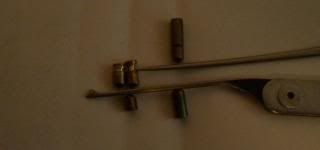

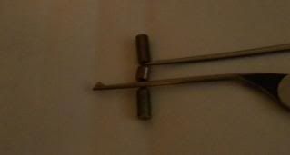

If you use a site tool, you may call it a straight pick if you like, you can feel if the split inbetween the pins. And hold down the pins on one side to check the other side. If you find a split this means that that side of the key is a shallow cut and the other side is a deep cut. If you can't find a split in a specific chamber than the key cuts will both be in the center of the keyway.
The serrations and anti-impression pins can make doing this annoying because your tool will catch on the serrations. Though to be perfectly honest this is still a valid method of attack against this lock.
Also someone mention an idea of trying to pick half of the lock, which would allow you to decode it. You wouldn't be able to turn it just click them in place to decode it. And yes on a hand made version of the lock that I have here this is certainly a possibility (though I haven't tried it). But if the plug was made from one solid piece instead of two, I don't think this would be a real threat. I'm sorry I forgot who posted this as I really liked the idea behind the attack.

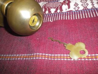

How strong is the key? Surely if this were a real lock, you'd use stiffer metal?

The key is stronger than I originally expected. But yeah I'm not going to try and break it.
My original idea was to make it out of a good piece of pick material. But finding a piece big (thick) enough and the fact that it would be much harder to make. I just grabbed the brass blank of the board and had at it. It has held up since so I haven't worried much about it. But yes I would definitely want to have the key made from steel if the lock were in use.

Maybe if the keyway was longer (taller?) to give more width (not thickness) to the key. Cause as the prototype stands now, the key will fail quite often. You could make the key out of some carbon fibre composite / alloy, but then it'd be expensive and hard to manufacture.
