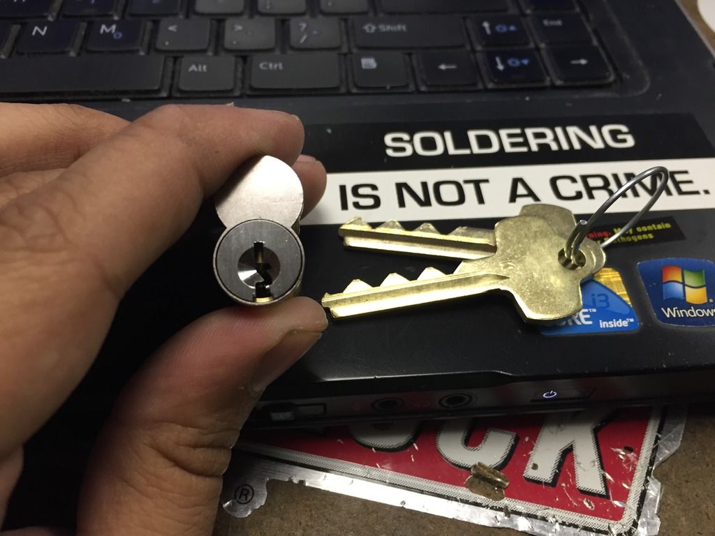

Postby Tyler J. Thomas » 24 Jun 2016 9:57
Pinned it up. I guess I reamed the chambers correctly because inserting, turning, and removing the key results in at least one binding chamber - I can hear the free floating pins moving. Tapping it a bit resets them.
I'll try picking it later and see if I can pull it off.

Postby Tyler J. Thomas » 26 Jun 2016 13:10
Played around picking it today. No dice.
After I originally drilled the chambers, I sanded the control lug up to 1000 grit. I left the plug itself alone. Because of the burrs, it's a tight fit. As a result, you have to increase tension to set any chamber, thus increasing the chances you set at the opposite shearline of whatever you're picking for.
I'll throw it in a housing tomorrow and send it out. Can't wait to see if he can pick it.

Postby jeffmoss26 » 26 Jun 2016 19:24
You inspired me to pin up a core myself:
