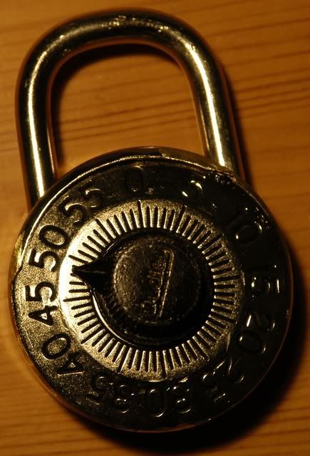

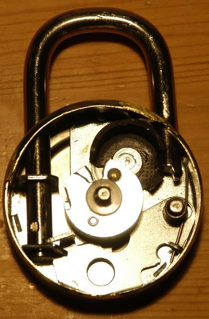

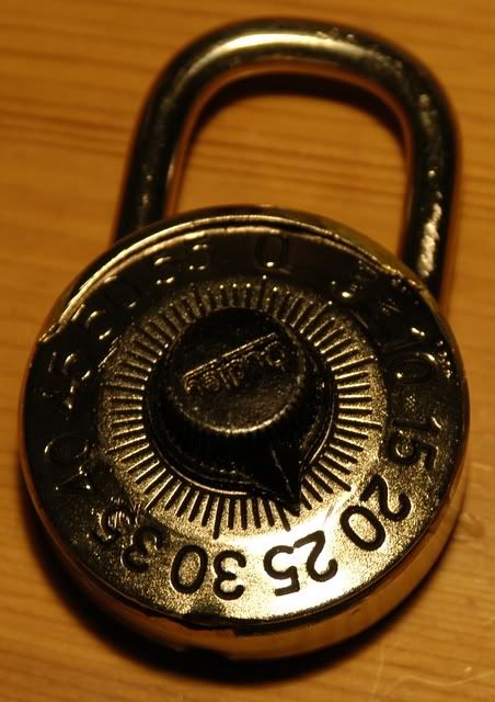

I tried all the method described to open a Dudley but none gave a reliable solution that can be done over and over. Since I am still waiting after my lock pick set AND I was not able to find good break down of a Dudley, I decided to make my own. Here it goes:
The Dudley:

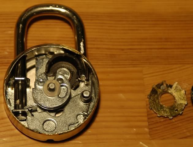

The inside:

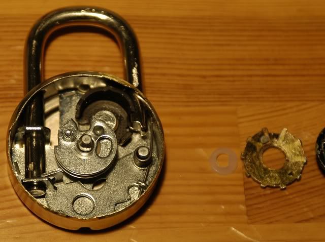

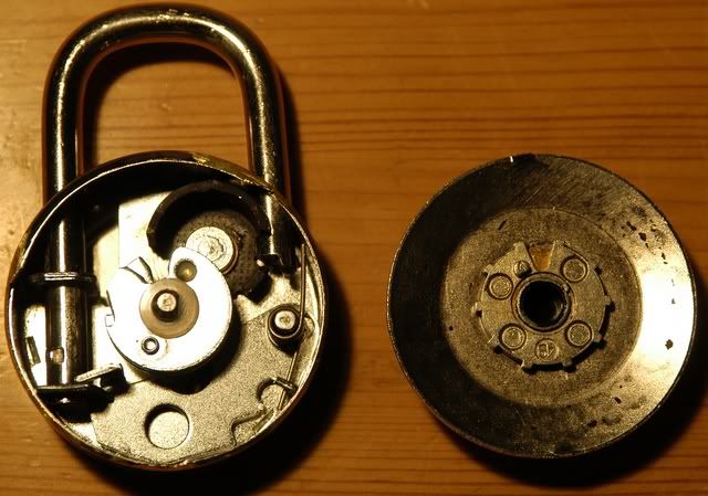

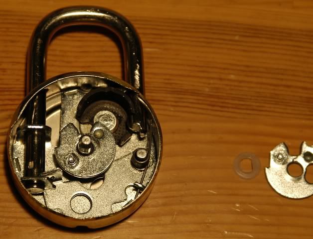

All parts:
You will notice that the gold disk come from an other Dudley because you have to break the dial to get it :(
On other picture you will not see it because it's behind the dial assembly.

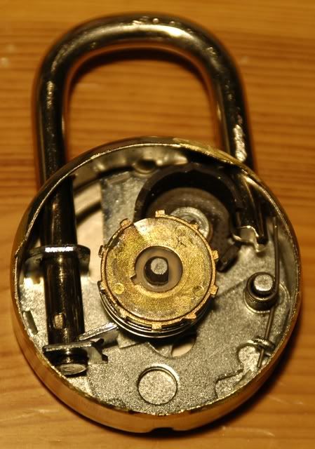

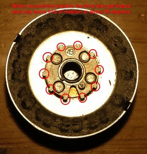

The back side of dial assembly:

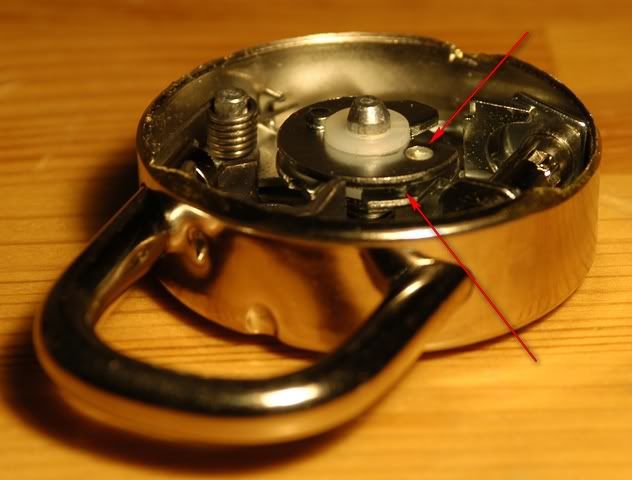

The inside view of opening sequence:
2 full cw turn and the third stops at 58
Inside. Notice the discs position

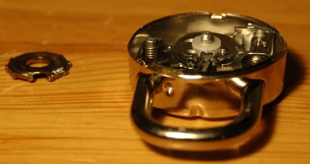

1 full ccw turn and the second stops at 24:
Inside
Turn cw until last number is reached. In this case it's 49
Inside
POP! It's open :)
Inside

Thanks for the great pictures. I was able to open my old dudley lock (the one with the black dial) within about 10min with the thin strips from the anti-theft devices. At first, I thought I got lucky or maybe I subconsciously remembered the combo so I grabbed a few more from my friends and was able to open all of them with relative ease. The ones with the black faces are easiest to open since you can pull the shackle and brute force the 50 or so combinations after getting the first number and the rings won't move out of place.
