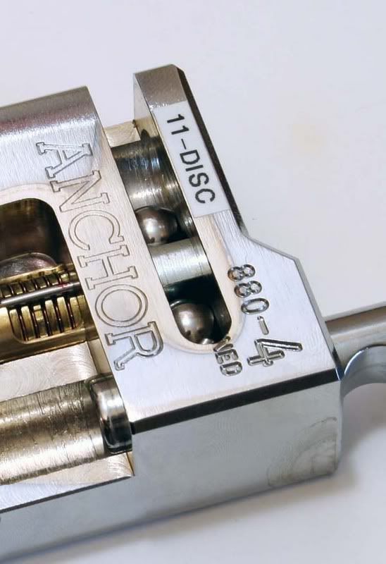

Postby zeke79 » 18 Sep 2006 21:25
True or not, there is no flaming here. Sure we all give each other some grief once in a while but this is getting out of hand. There are some padlocks out there that are not deadlocked that can be shimmed that use decent locking cores. I am sure he has just ran across one of them.
Fact of the matter still remains the same that you cannot shim a deadlocking style padlock as seen here.
As you can see, the locking cam is lobed so when locked the bearings have no place to go and can not be shimmed back. The cam cannot turn until the key is placed into the cylinder and the cylinder is turned to allow the bearings to withdraw and the shackle to release.
Postby LockNewbie21 » 21 Sep 2006 22:07
Ahh thank you zeke :) by the way sweet cutaway bro.
