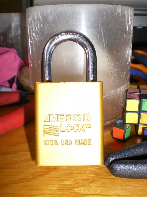

i am going to pay to get my lock open anyway. the only reason i bought my kind of lock again is cuz it was cheap.....anyway, i might b able to get a pick set but if i dont i think i'd like to bump it..
is it possible with this key though?
http://i129.photobucket.com/albums/p223 ... k/key1.jpg
http://i129.photobucket.com/albums/p223 ... k/lock.jpg

If you have the key for the lock and the lock has pins, then you can make a bump key for it. File all of the trenches down to the "9" position.

Dude, to be truthful if you had 20 of those keys I doubt you could make a working bump key. I just don't think you could do it from reading your posts. Plus it is a lot harder to bump a 1105 because it has spools and serrated pins. Just give up, get skilled in basic lockpicking then go back to learning how to pick the 1105 or getting a code cut bump key when you have the skills.

The 9 position refers to the deepest cut for most locks. American only uses 8 depths according to my books. If you file all the cuts on your key until you get a micrometer reading of .175 you will have your bumpkey.

That would be cool if you could eyeball a key by looking at a picture of the original and get the depths right. 8) I would say find the key with the deepest cut the file all to match the deepest cut.
