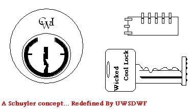

Neat key, pin tumbler + tubular
Postby horsefeathers » 6 Jun 2007 12:03
Gotta be a fake......surely?

what mine?... of course I just came up with it... (from a shoes concept)
Postby Schuyler » 6 Jun 2007 12:27
UWSDWF wrote:what mine?... of course I just came up with it... (from a shoes concept)
I'm gonna make it...I think I can...MAYBE
Postby UWSDWF » 6 Jun 2007 12:42
<work I just realized I can't use> sexy.... keep me in the loop... and the name must stay the same unless you plan on going commercial
Postby Schuyler » 6 Jun 2007 12:47
I'll likely never go commercial :P I just miss doing my stupid lock mods and could use a good project.
Postby Charodei » 6 Jun 2007 14:19
If you're feeling really crazy, you could separate the keyway into two sections, one circular, the other the straight center part. The key would be strange, having two 'prongs' with a slot between them. This would let you put dimple pins on the bottom of the lock. Throw in a bunch of security pins and such, and you'll have a lock that's nearly impossible to pick.
The machinists making it would hate you for giving them such a nightmare.

common type actually
Postby raimundo » 6 Jun 2007 14:42
The key photographed, is a common type found in bus depots on the small 24 hour storage lockers. I have a few of them in my collection somewhere, but the name of the lock maker? I don't know, possibly greenleaf as they make things for this kind of application, I'll google bus locker key or green leaf and see what I get, after Im on here for a little while and move on to googl.

good job redrawing my original drawing!
In response to someone saying that the keyway would be gigantic making picking easier, make the key a hollow tube so theres a post in the center of the keyway. That would obstruct what would otherwise make a very easy set of pins to pick. you could also make the post in the center able to rotate only with the tubular pick mechanism, while the pin tumbler mechanism would rely on the blade part of the key to rotate that assembly, so that any attempt to pick it would aslo have the wrench obstructing the keys.
hope that was clear enough, dibs on the concept. :D

Postby metalking00 » 6 Jun 2007 18:30
In response to someone saying that the keyway would be gigantic making picking easier, make the key a hollow tube so theres a post in the center of the keyway. That would obstruct what would otherwise make a very easy set of pins to pick. you could also make the post in the center able to rotate only with the tubular lock mechanism, while the pin tumbler mechanism would rely on the blade part of the key to rotate that assembly, so that any attempt to pick it would aslo have the wrench obstructing the keys.

Postby blake1803 » 6 Jun 2007 20:20
metalking00 wrote:hope that was clear enough, dibs on the concept. :D
Crystal clear ;)
Some good thoughts in this thread! Cheers

Postby linty » 7 Jun 2007 16:42
the keyway isn't gigantic, it looks a lot like the drawing...kind of like a tubular lock with a keyway in the middle.

Postby metalking00 » 7 Jun 2007 19:56
I think having the bitting on top would make it harder to pick, since there'd be no place for the wrench to go.

other concept
Postby raimundo » 20 Aug 2007 8:20
think of a U shaped key, (a bit like a bi lock) with the bottom of the U as a part of the tubular keyway, and the two tops cut like bi lock, so you have two flat blade keys with a round part that you can put tons of pins on.

Postby SnowyBoy » 20 Aug 2007 21:09
UWSDWF wrote:soooo... I took shoe's idea and exploited it and made it different slightly..
the tubular part I am thinking would work like a small Drumm Geminy....
what do yeah think
ohhhh and copyright me.... take it and i'll kill you
Too much gap round the outside.....plug would be loose as arseholes in there.
