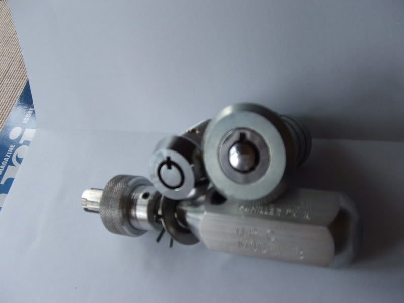

Just to make it clear "johnny p"
Normal cheap sort left, expensive right

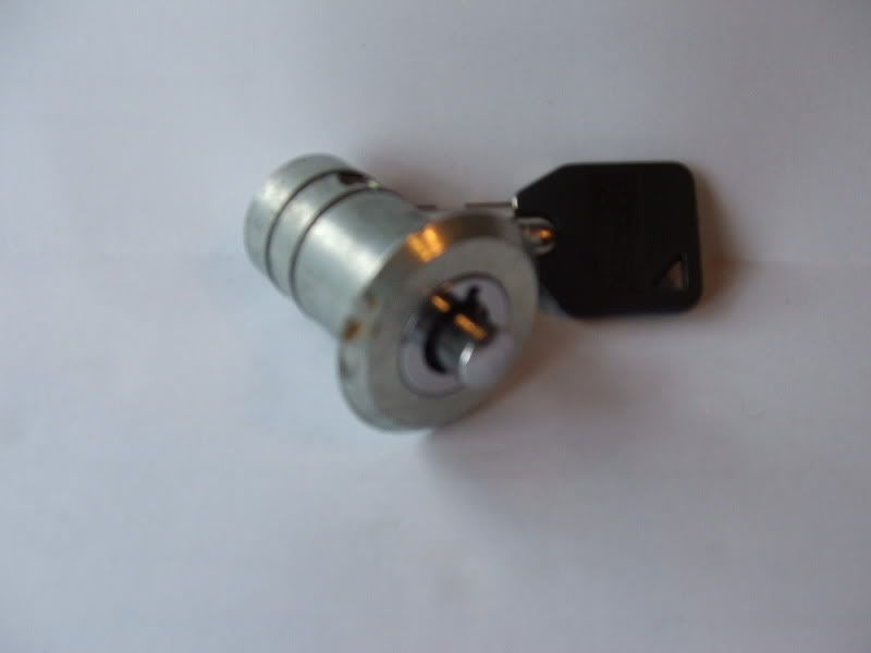

When unlocked and key removed

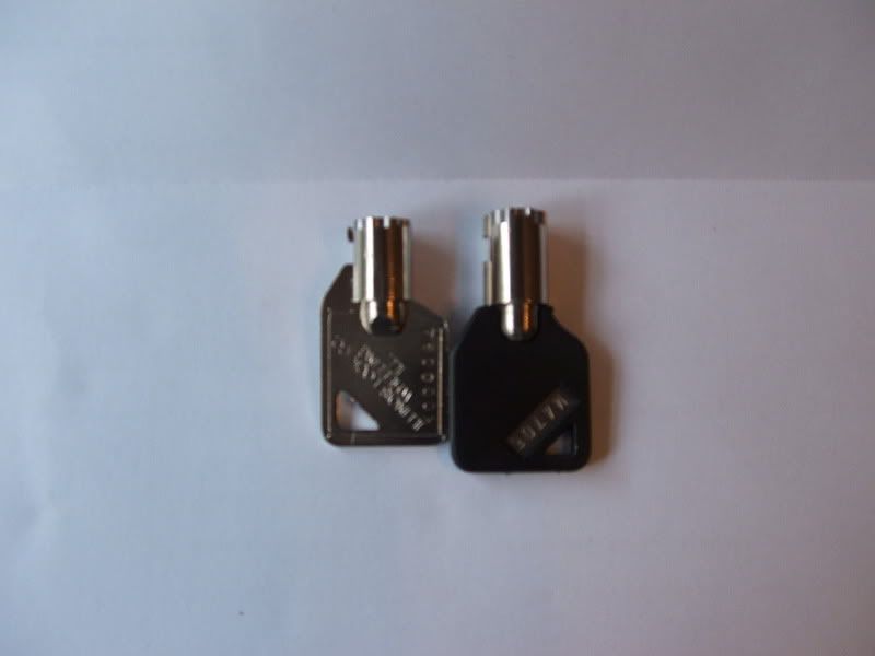

Difference in keys, cheap left.. expensive right

This looks to me like a good candidate for a pick like the CSP. It does NOT use a nub to apply tension. The sleeve the feeler picks ride on is able to be adjusted tigher around the center post to apply tension. This along with the pins sitting in the grooves for the feelers is what allows you to pick and turn the lock.
I have one csp pick and it is the best pick I have ever used. I like it way better than even the peterson pro 1 I had a while back. I do not think the csp pick is produced anymore however. It is a very good pick though. It even allows you to take a key that has had the tension nub broke off and combinate the feelers to the key and open the lock. A real nice piece of engineering.

the centre piece doesn't actually turn though, once the key/pick is put in and turned all the top pins move around in a circle with the key. It's hard to explain really.

Postby Johnny P » 31 Aug 2007 3:44
You're correct. I didn't look closely enough at the picture.
For that lock, just buy a BIC pen or use a tube from a roll of toilet paper ala Barry Wels.
I certainly wouldn't ruin a good HPC pick to pick that lock.
