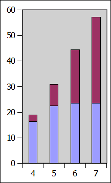

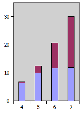

Just for fun:
The percentages of successful openings, blue is the guy that goes all 1's, red is the guy that followed the best combo to that number of rakes.
http://i246.photobucket.com/albums/gg93 ... f/4pin.png
http://i246.photobucket.com/albums/gg93 ... f/5pin.png
http://i246.photobucket.com/albums/gg93 ... f/6pin.png
Note that the values are not continuous!
As usual the, data is very flawed, so this is to be taken with a grain of salt.
