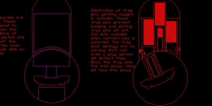

I have finished (or at least I think) the cross-section view

Postby wtf|pickproof? » 30 Aug 2005 5:23
Did you ever think about the assembly of your lock? Especially the locking mechanism for the trap pins looks _really_ evil IMHO.

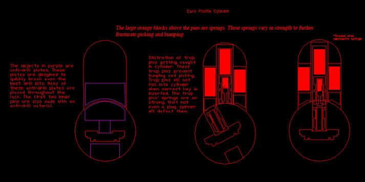

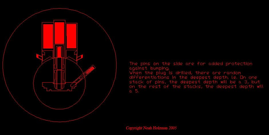

Postby n2oah » 30 Aug 2005 14:48
wtf|pickproof? wrote:Did you ever think about the assembly of your lock? Especially the locking mechanism for the trap pins looks _really_ evil IMHO.
Assembling this lock would be considered cruel and unusual punishment. :lol:
Here are all of the drawings together.
