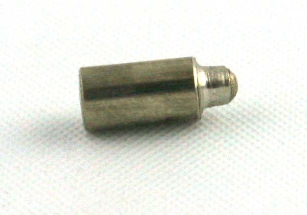

Postby zeke79 » 3 Sep 2006 20:49
How about this idea:
A bump proof pin :wink: .
Of course this would not be a fix for those using the pull back bumping method.
