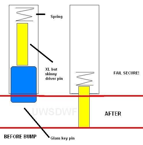

Postby UWSDWF » 11 Nov 2006 14:10
So the idea is that only one (1) of this pinstack would need to installed in a lock.
The force of bumping would shatter the glass (i'm sure a plastic could be developed making it cheaper and quicker) keypin, thus refuting the intention on this pin. When the key is drawn the long but skinny driver would fall into the keyway ( requiring a lockie to open it) leaving the lock in a fail secure position. thus making the lock unbumpable
Questions, comments, concerns?
Postby Romstar » 11 Nov 2006 14:17
The broken glass has no place to go when it breaks. Also, it should adequately transfer the force to the driver at least he first time so that the lock will open.
It gets fun when you remove the bump key. THEN the lock fails in the secure mode, but the opening was already acomplished.
If the key pin were hollow it may work, but the stress of normal functioning would probably break it and you have the same result, only with an authorized key.

Postby UWSDWF » 11 Nov 2006 14:40
I believe that the transfer force from the bumping would be drawn by the breaking of the glass pin (an idea to increase the chances would be to score the pin in a spiral around it, just not deeply) and that the only way the authorized key would break it would be if somone jammed the key in there really hard
again I've never tried it so I may be wrong
Postby Romstar » 11 Nov 2006 15:21
Its a good thought at any rate. I am just reluctant to use anything with glass.
Not to mention that as I said, there isn't a lot of place for the glass to go. So its possible it may not work in the way you have thought.
It shouldn't be too hard to make something up though. I think I have some glass around here somewhere.

Postby UWSDWF » 11 Nov 2006 16:00
a scientific glass stirring rod might be perfect to try with....
Postby Romstar » 11 Nov 2006 17:43
Pyrex splinters more than breaks. Its one of those things you have to weigh. Tempered glass might do the trick.

Postby maxxed » 11 Nov 2006 17:43
A glass relocking device, interesting, I agree with Romstar about the durability. I wonder if after the glass is broken and the glass fragments removed could the lock be bumped at that time. The driver pin may simply fall into the keyway leaving one less pin to secure the cylinder or it may allow another try with a bump key.
maxxed
Posts: 736
Joined: 18 Mar 2006 12:09
Postby maxxed » 11 Nov 2006 17:44
Romstar wrote:Pyrex splinters more than breaks. Its one of those things you have to weigh. Tempered glass might do the trick.
Romstar
Tempered glass like that used in relockers is tough but when it goes it really goes
