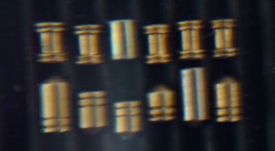

I am thinking of disecting my R-70 becuase i can pick it in literly seconds everytime, i wil le toy know how it turns out, Hey if any body has a camera and the brinks 6 pin pins all taken out could you post a picture of the buggers, my cut away is okay but i cant see the pins in there whole, shows a very nice example of the pins in action plus false sets and negitive plug rotationt hough.

Postby jimb » 18 Apr 2006 0:16
LockNewbie21 wrote:Hey if any body has a camera and the brinks 6 pin pins all taken out could you post a picture of the buggers,

Postby LockNewbie21 » 18 Apr 2006 1:29
Thanks jimb, Its a very impressive ureay of security pins, i have even more sence of accomplishment not that i see what i picked and had no idea. And to anyone else who has congrats, Thanks again jimb for the pics buddy.

Postby illusion » 18 Apr 2006 7:55
Those are some nifty security pins. :P
for $10 it's a pretty good investment. :)
Postby pinsetter » 18 Apr 2006 13:42
OK, that's evil!
I didn't realize the spool pins that Brinks use were also serrated, but I did realize they use serrated bottom pins.
That picture is worth a thousand words!
Thanks much for posting that pic!
