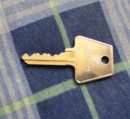

Here's the key, it looks like the Rocky Mountain horizon :shock:

oooooh, those two high pins in the center behind the extremely low one, now that looks VERY challenging to pick when combined with those pins!

Heh, with that key cut and those pins I can understand why. Of the 6 pins three are high pins behind low ones, which is a tricky cut in itself without the added headache of 10 security pins out of 12.

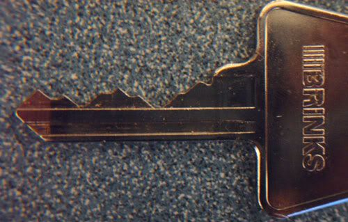

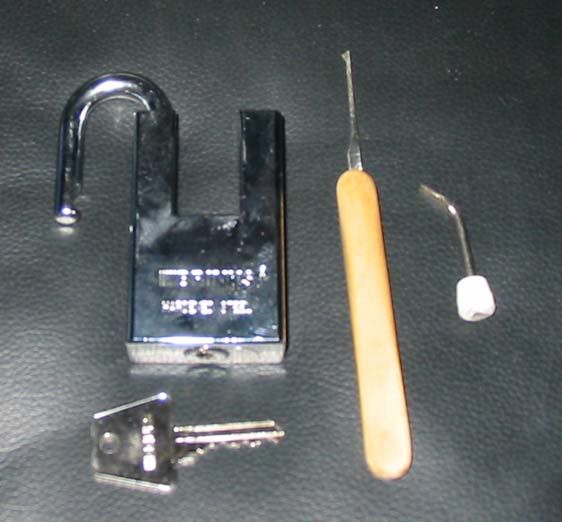

Well, I just bought the Brinks 6 pin shrouded lock tonight. I was actually expecting more of a challenge. I opened it for the first time in 9 minutes by single pin picking. I'd say it could be done much quicker by raking first followed by pin picking. I picked it with the tools in this picture. In this picture you can see a detailed bitting of the key.
Was 9 minutes ok for a first opening of this lock?

The biting is not really nasty, but certainly not simple.
Does the shrouded version have the crazy bottom and top security pins?
9 minutes would seem okay for a new lock, is this time consistent?

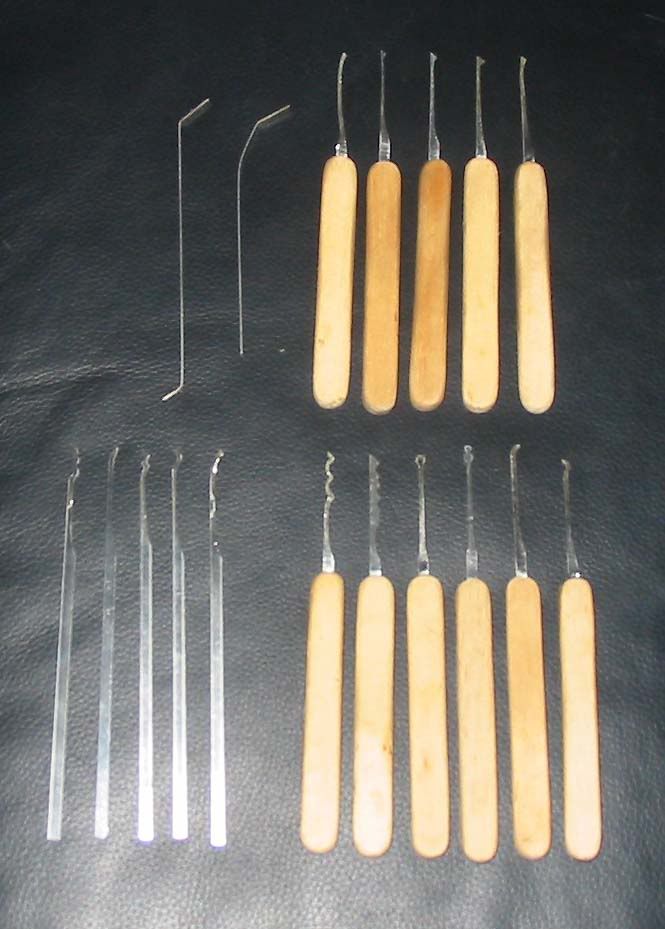

I like your h-diamiond pick :)
Postby pinsetter » 27 Apr 2006 21:15
I haven't tried it again yet, but I'm sure I can open it again about as quickly. It is really obvious when the spool pins reach false set in the actual spool cuts, and getting a true set from there is not real hard.

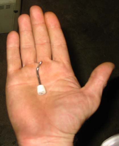

Notice that I'm using a very short tension wrench with the security pins. I actually use my thumb for tension and just basically lay it on the white knob. This keeps me from putting too much torque on the plug. This lock also had the AM4 keyway, so it was a bit tight, but with my small tension wrench I still have plenty of room to work. If you look close at the AM4 keyway, if you use a very small tension wrench, the very center of the keyway between the wards is wide open, it even leaves room for my larger half diamond.
Since you liked my pick, here's a picture of the set I'm making. I still have to put handles on the 5 in the bottom left of the picture. I'm not sure how many I'll end up with. I'm making all of them out of those steel strips from wiper blade inserts, and using paint stirring paddles for laminated wood handles. The picks are very sensitive feeling with the insert laminated in a perfectly sized groove in the light wood handles.
Oh, and here's a picture of that tension wrench in my hand to give an idea of how small it is. It really helps to keep from over doing it. :wink:
