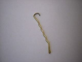

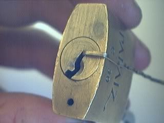

Postby Wrenchman » 2 Oct 2007 21:07
Trip Doctor wrote:Wait waa... what does that have to do with impressioning or measuring ?
TD, I'm glad you asked!
By measuring the pins when the lock is in an open position, using for example a
long hook, you can estimate the pin depths and thereby impression a key a lot easier!
With this tool you don't have to keep tension all the time and thereby get tired in your
hand with the chance that the tension-wrench might fall out not to mention that you'll
have to work with on hand during the whole process!
:D

Postby globallockytoo » 2 Oct 2007 21:19
Wrenchman,
In your example, the process you describe in lock reading is quite common.
Papaiz locks are extremely easy to pick or impression, even though many have spool pins
Whilst being an alternative in making a key, I think it will rarely be called upon.
Good thinking tho!

Postby kg4boj » 2 Oct 2007 22:09
I never did it that way but I can see how it might be useful if you are just getting into wafer/pin reading. You get it in your head... from bow to tip (how lock bitting is usually listed):
front pin.... second pin is lower than first pin third pin is higher than second, but by looking down the keyway, you can see its not higher than the first pin... then you see the third, witch is lower than the second, and the fourth, witch is higher than the second and the same heighth as the first so you look at the depth and spacing for that lock and say you find there are 5 diffrent depths,
From what you read from the picked lock you know the third pin is the lowest, followed by the second and you see the first and the fourth are the same heights, you can make a guess for any one pin say...
of 5 depths, if none of them are real short and look like 1's
the bitting might be (bow to tip) xx4x third pin being lowest...
then: x34x second pin being lower than the first
then either 2 or 3 for the first pin, unless it looks more than a single step and you dont believe have a #1 cut
234x
and you know the first and fourth are the same depth so you might try:
2342 as your combination and if all goes well it should work, if not try offsetting all the numbers by one, or cutting one cut shallower than you think it might be if you aren't sure of its exact depth, and impressioning it down ( this is one pin tumbler impression that works well with a knife edge)
If there was any doubt I would cut it as 1231 then 2342 then try 3453.... and if it didnt work from there, I might try 2352 etc and so on.
That make any sense to you guys?

Postby kg4boj » 2 Oct 2007 22:12
blah, not with it tonight: lets try this again:
of 5 depths, if none of the pins are real short (#1's), or all the way #5 deep ( pin extends almost to center register groove) or look like 1's
234x
