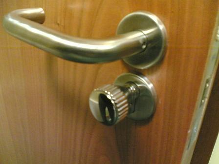

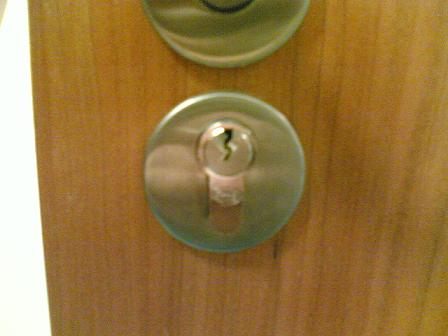

I know this forum says that beginners should stay away from Corbin locks but there's loads of them around here and one's that look like immetation corbin's. Could someone please describe the feel of picking one of these locks
See attached photo's, there's a knob on one side and the keyway on the other. I've managed to get five pins in position, after I release the tension five pins can be heard to click! How many pins to I need to put in position and what makes the Corbin so bloody hard to pick??

Neither link works for me and the pictures don't show up.

The technique is setting the pins, not just pushing them down.
Do you know EXACTLY why a lock can be picked?
If not, have a good read of the MIT guide.
Do a search for MIT on this site, you will find it.
You said in your first post that you are new to picking.
That is all we need to know, to advise you to not bother with that lock.
It isn't about being scared of it, it is about being able to set four or
five security pins and a normal pin at the front.
Can you pick one security pin? Two? You won't have any joy with that lock
just yet, dude.
Go get some cheapo locks to play around with for a while, and gradually
move up to harder stuff like that lock.
What you are basically saying, is, "I just learned how to not stall a car.
.....What technique do I need to race a Ferrari today?"
Trust us. Put that lock in the 'not just yet pile' dude.

Magnethead, stay away from that lock until you get a little more experience. It has a pretty nasty keyway, and I'm guessing there are some spool pins to go along with it.

I think He has to big pick for this lock. Picks maded with hacksaw blades is not good to pick this lock. I know this because in Poland (I am from there) is very much of this lock with tight keyway. I proper to make a new pick with wires blades.

corbins usually have spools or mushrooms in them, to pick spools or mushrooms, you need a light touch, and must be sensitive to the feedback from the tensor, if it starts to reverse, let it, until the pin sets, then look for another spool, by touching the other pins lightly until one starts to reverse in the same way, this may cause the one already set to drop, but don't let that bother you, just reset it. you will eventually get it and after that do it again until you can do it consistantly, this the real learning experience. 8)
