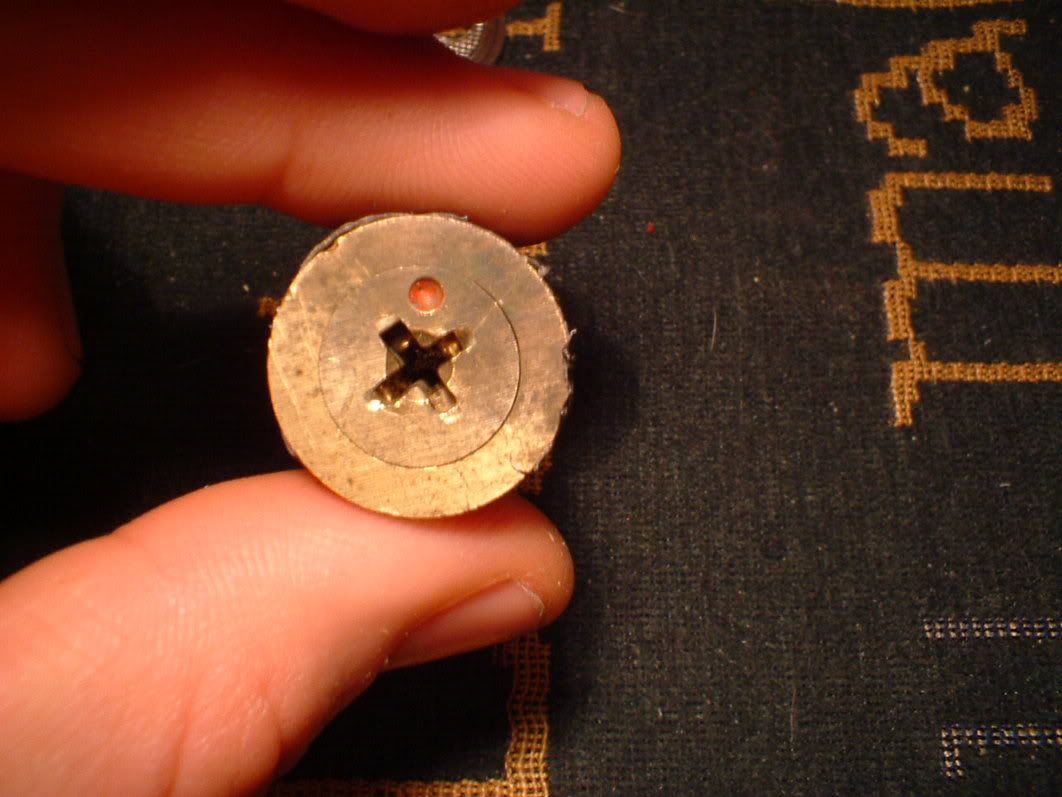

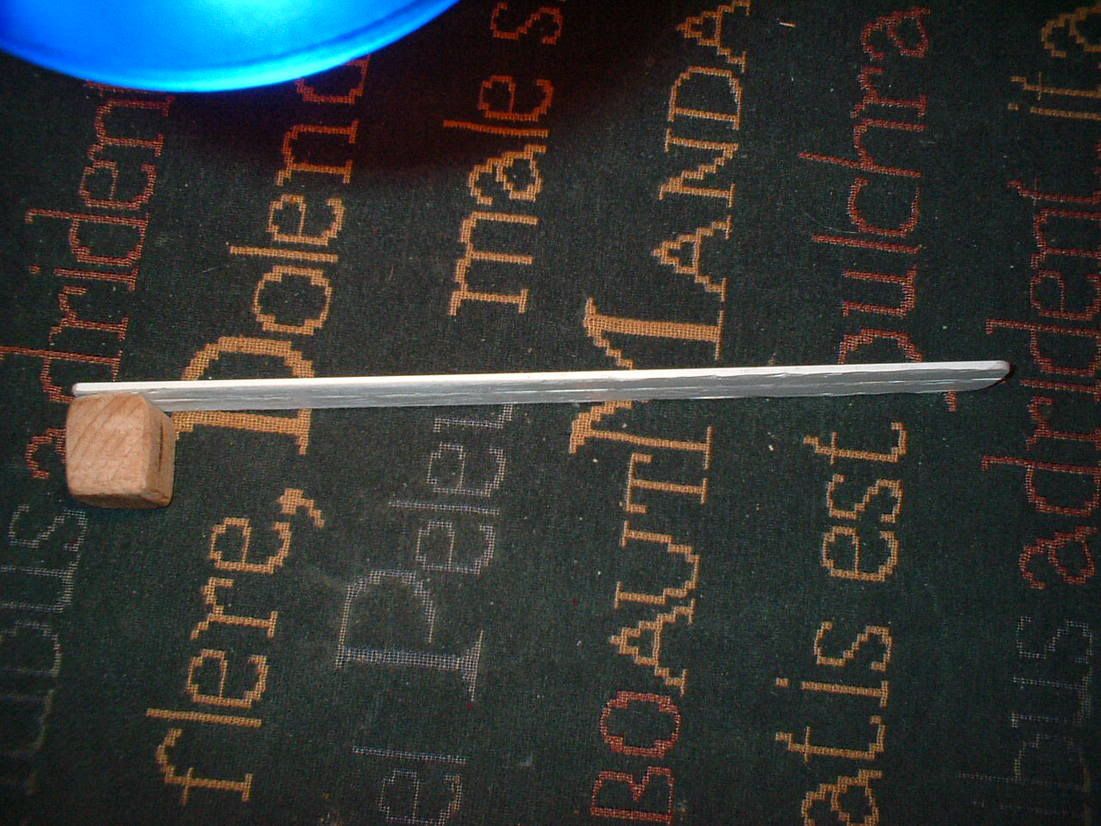

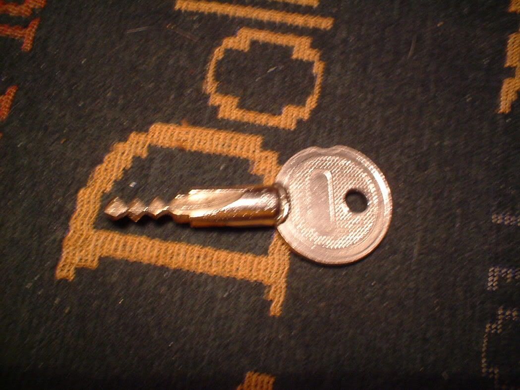

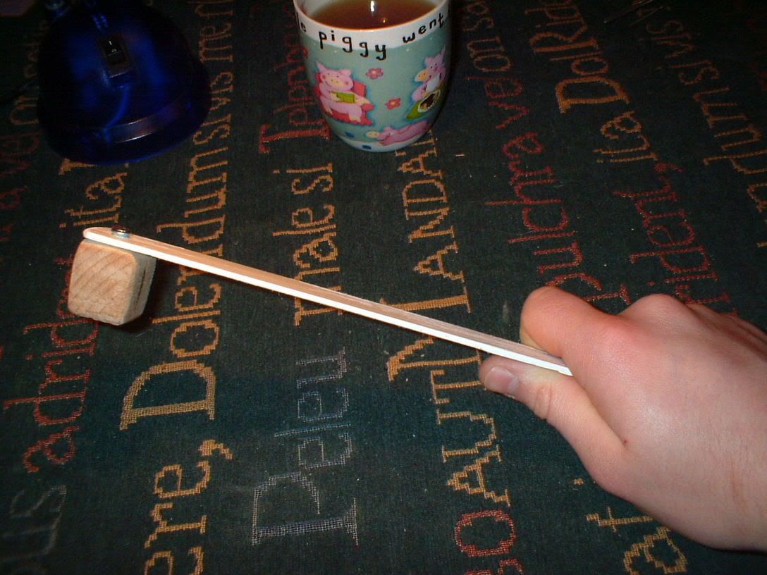

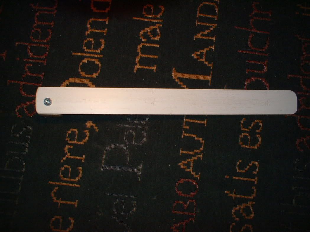

Okay guys, so likely you'll remember a short while back a thread talked about bumping a cruciform lock. I went away and began filing down a bump-key and got to work practising with different tools, but found all the ones I usually use inadequate - it turns out that the best solution was to simply make a tomohawk style hammer.
The handle of the hammer is made of PVC... and the striker is made from a piece of Oak I simply carved into shape... this is fixed to the handle by a cross-head screw.

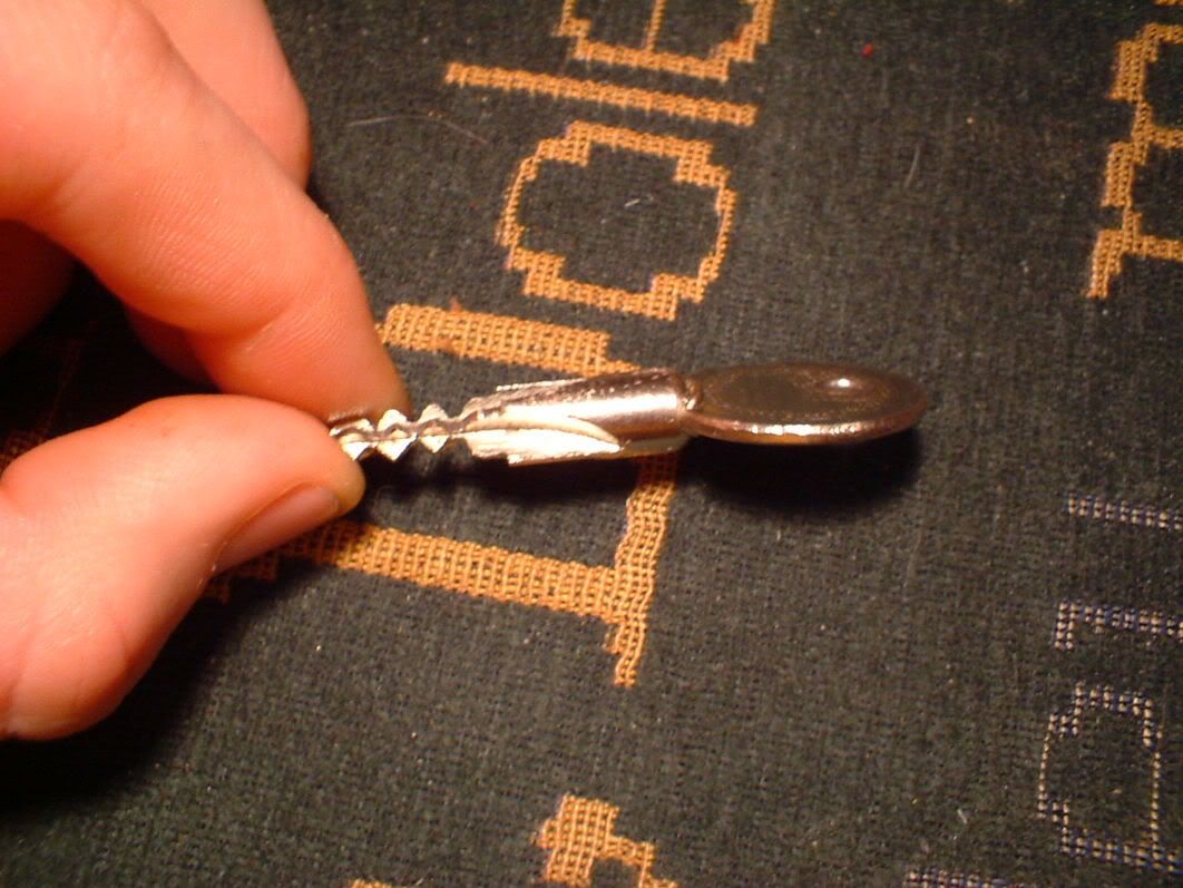

Once I had made the hammer I had a greater degree of success, yet only when pulling the bump-key out one space before bumping it has it been succesful - the minimal-movement methord sadly didn't work despite removing material from the shoulder and the tip of the key. However it does indeed work every time so I wasn't dissapointed.
The movies are relatively small, ie: 3mb each so no worries about download times.
Annoyingly I'm still having to use my digital camera to film, and whilst I'm greatful, a time-limit of 20 seconds is somewhat constricting.
The bump-key was somewhat hit-and-miss, and eventualy I ended up filing it all the way down... well perhaps give-or-take a bit it was incorrectly cut in regards to the depth, but it does function, and every time, so I'm happy :)
Here are the two videos I took of me bumping this lock:

images of the bumpkey and lock here:
http://i16.photobucket.com/albums/b25/j ... CF0226.jpg
http://i16.photobucket.com/albums/b25/j ... CF0225.jpg
http://i16.photobucket.com/albums/b25/j ... CF0227.jpg
http://i16.photobucket.com/albums/b25/j ... CF0228.jpg
http://i16.photobucket.com/albums/b25/j ... CF0229.jpg
bump-key hammer:
http://i16.photobucket.com/albums/b25/j ... CF0232.jpg
http://i16.photobucket.com/albums/b25/j ... CF0233.jpg
http://i16.photobucket.com/albums/b25/j ... CF0234.jpg
http://i16.photobucket.com/albums/b25/j ... CF0235.jpg

When you say you filed it "all the way down", did you just pick the deepest cut and file the rest to follow suit? Or did you file right down the the crossroads and leave the hills?
Chrispy
Posts: 3569
Joined: 24 Mar 2005 15:49
Location: GC, QLD
Postby illusion » 5 Jan 2006 8:14
I filed them down to the crossroad, but I reduced the height of the hills to the same length. I went to the deepest cut and then just filed a bit more away, but the deepest cut itself was basicaly at the crossroads...
