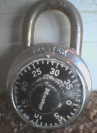

Determining the combination to a Master combination padlock
Postby jeremy » 12 Mar 2006 2:05
Well, I agree that you're contacting the fly of wheel 2 with the drive pin of wheel 3. If that's what you're feeling, it really does have no relation (other than coincidental) to any number of the combination. If you find this method consistently successful, however, then it's clear that you're actually feeling something else. In that case, please fill us in on what you find.
Now, let's go over how the combination to a Master combination padlock can be quickly determined. This applies to Master padlocks that look like this:
Image (This includes the cute Sphero padlocks.)
Originally, these locks had no false gates. This made it extremely easy to determine the last number of the combination. Pull out on the shackle while rotating the dial. The shackle will pull out in only one dial position. While holding it out, rotate the dial back and forth as far as it can easily go (just a few numbers). Consider the integer closest to the middle of that range to be the last number of the combination. In the math below, this is 'g[3]'. (This method of determining the last number of the combination applies to all direct entry combination locks without false gates. This includes some safe locks but not most.)
(Note: These locks have 3 wheels and thus 3 numbers to the combination. The 3rd number of the combination corresponds to wheel 3. The dial is connected to wheel 3 and drives it directly. Wheel 3 sometimes drives wheel 2. Wheel 2 sometimes drives wheel 1.)
Since most of these locks have false gates, it becomes slightly more complicated. I'll talk about that in a future post.
