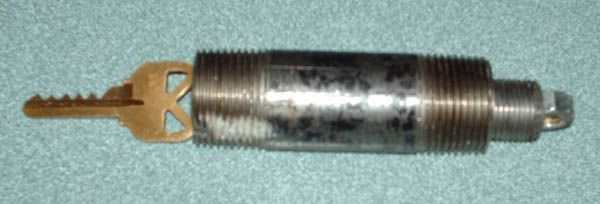

I can't take credit for the idea but I liked it so I made something to see if it was possible. There's lots of room for improvement and I built this for 6 bucks and some change. If anyone's interested in instructions I will post them later as I don't have enough time at the moment.

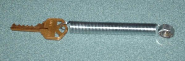

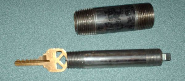

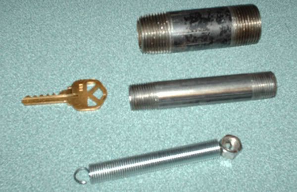

Here's a breakdown. It's simple and self-explanatory. It's not the best-looking tool and there is tons of room for improvement, so someone improve it or build a better one and tell us how you made it.
I took a file and filed grooves for tension as you can see in the 4th photo. When I did this the key wanted to slide into the pipe so I took a hammer and beat in the sides a little.
I also clipped the end of the spring to make it easy to change keys.
Materials used:
3/4" x 3" Steel pipe nipple
3/8" x 3 1/2" Steel pipe nipple
7/16" x3 1/2" x .047 Spring
1 hex nut from my Garage
jimb
