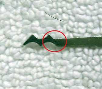

It appears that you raked these locks mostly with the "S" rake pick, one that was inserted into a polished brass handle. Do you own the PXS-17 set from Southord? A polished brass handle comes with that set, and that set only, as best that I can recall.
As for the method of raking that you use, it makes me wonder if you have ever had your "S" rake pick break as a result of it. That rake is very thin where the "S" part begins, which is the rake's thinnest point. This is shown within the area encircled in red with this photo below.
The up-and-down wiggling motion that you were doing in your videos, as you raked the pins with your "S" rake that is, appeared to me as being excessively stressful upon the section of this rake at its thinnest point. This is why I always tell people that the "S" rake is best used when one only moves it with an in-out motion to rake the pins.
I know all of this from the misfortune of seeing my "S" rake picks get broken on five separate occasions. All of these breaks occurred within that area encircled in red in the above photo, and all were done by people who were new to lock picking and failed to heed my advice on how to use this particular rake.
Two of these occasions occurred at HOPE Number Six. Also at HOPE Number Six, I met a man who managed to break his Southord "W" rake pick inside a padlock that he was trying to pick. This rake is also one with a rather thin area just before the head end of it. The "W" rake is one such as shown in the photo below.
This fellow was also a complete newcomer to lock picking. He also appeared to be wiggling his "W" rake pick in a up-and-down motion just before it broke.
If raking is done carefully and in a manner that I and many others would consider to be proper, one's picks should never need to be replaced due to breaking.

Yeah, I have found that my favorite raking tool is the S rake. I have broken one of the S rakes using this method. I see now why it broke soo easily. I have since ordered five other S rakes to make sure that I have others. I will try to find a double half diamond online(or i'll make my own) as that would be much better for raking. Thanks for the comments. And yes, I own the PXS-17. I almost never use the handle, but after a few hours of picking, the picks dig into my hand a little, and I use it mostly for comfort. I keep meaning to get the dipping plastic to make some handels for them. That would be much better. oh well. I will make some more whan I have the chance. Oh yeah, and that six pin have security pins in it believe it or not. I guess I could make a video of me picking it, and then taking it apart to show them, but maybe another day, I'm way to tired right now.
