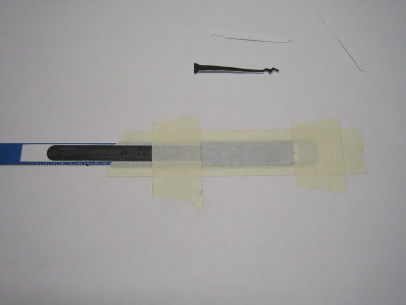

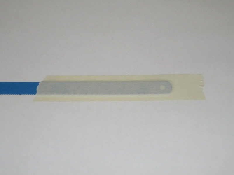

Here is the way I transfer templates to my choice of pick blanks, hacksaw blades.
Materials needed:

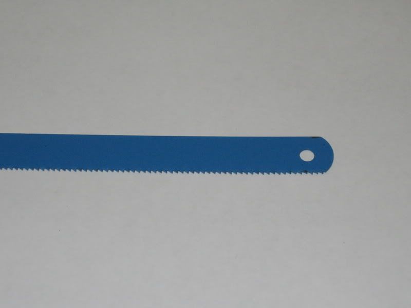

Hacksaw blade
Masking Tape
Black Sharpie marker
Exacto knife
Template
Here we go.

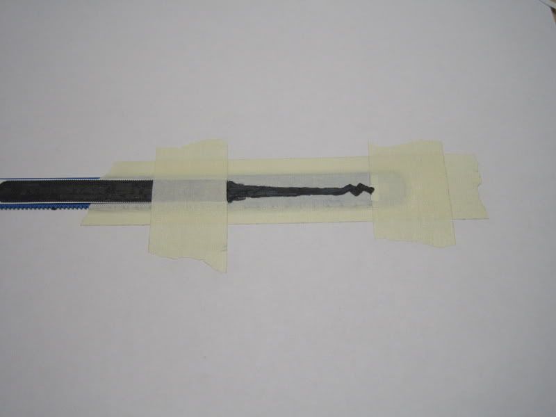

Step 1:
Tape hacksaw blade down to working area.
Step 2:
position template onto hacksaw blade.

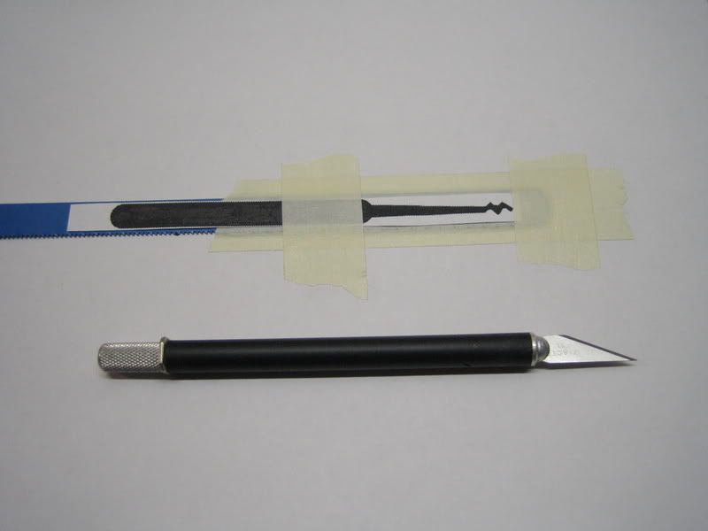

Step 3:
Add additional tape to hold template in place. Use knife to trace the outline of the template, cutting through the template and the masking tape.

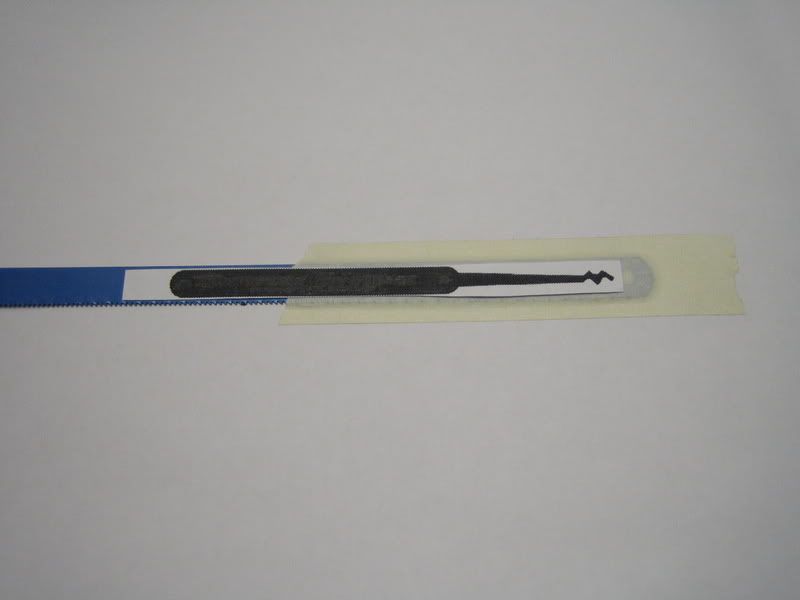

Step 4:
Remove cut up part of template, leaving masking tape alone.
Step 5:
Remove the masking tape to reveal template outline on blank material.

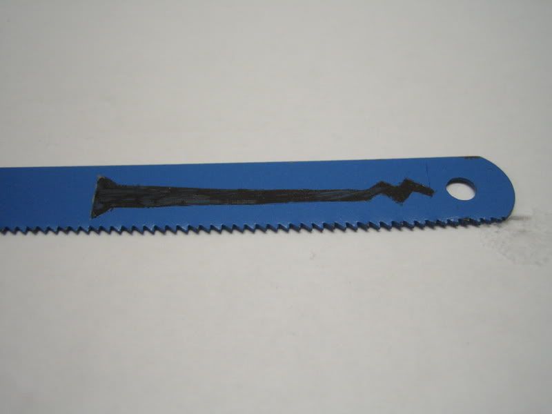

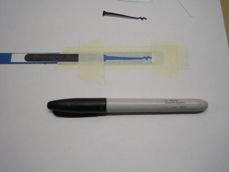

Step 6:
Color blank with sharpie.
Step 7:
Remove all tape from blank.
The sharpie is permanent and survives the quenching.
Hope this helps all you homebrewers to make some nice picks.
