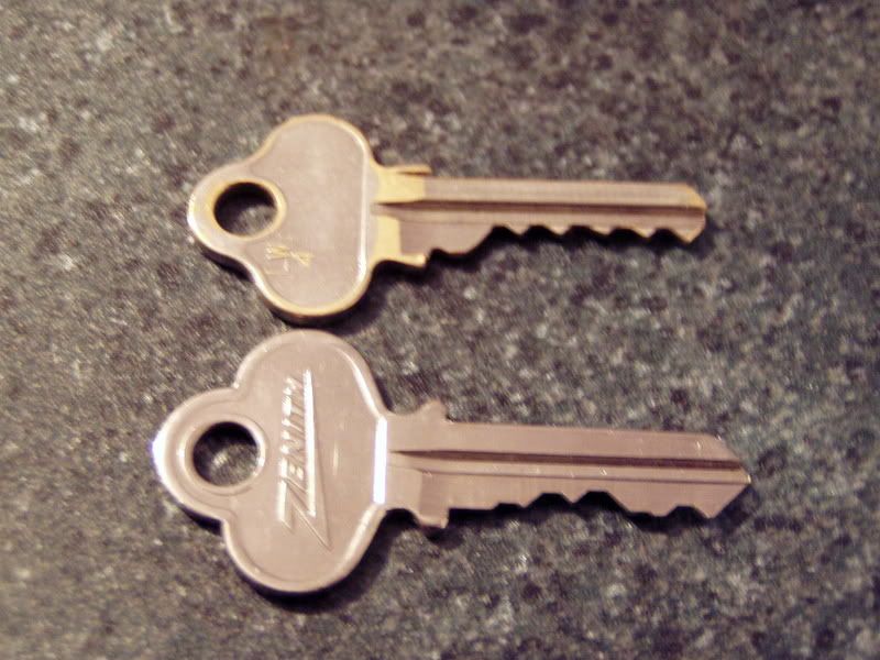

Postby mjwhit » 28 Jan 2007 3:18
i think the problem is its not deep enough.
wen u put the key in a lock the pins should sit in the valleys without bring pushed up.
some people even file further than the deepest so that it doesnt touch the pin until it gets hit.
Heres a pic of a bumpkey i made compared to the key from the lock. works really well.
haah i looked on preview and realsised my sig actually has a good example of a bumpkey on it.real deep and wide valleys. you dont need much "ledge" on the key for it to work. So everyone look at my sig.

Postby zeke79 » 28 Jan 2007 11:48
The problem is not that is isnt cut deep enough. The problem is that the cuts are not wide enough. Kwikset locks require a .090" flat due to their pin design. The way your key is cut, the root of the V is deep enough but that root depth is not wide enough. So what is happening is the pins do not fully seat to the deepest cut on the key and likely simply by inserting the key you have seated a pin across the sheerline.
Here is a properly cut Kwikset bumpkey.

Postby bulletsnz » 31 Jan 2007 6:16
just a quick guestion here,why is the first mountain bigger than the others?
bulletsnz
Posts: 9
Joined: 18 Oct 2006 2:48
Location: New Zealand,christchurch
Postby Wolfe » 31 Jan 2007 19:19
you know thats a question ive never seen nor have i ever come across anything about that.In other owrds good question. Im going to go out on a limb here n say that most locks like schlage kwick n so forth do not use that last steeple im going to have to assume its just to push the pins up n out of the way as the key is inserted.
Wolfe
Posts: 247
Joined: 9 Jan 2007 11:56
Location: East Coast
Postby mfschantz » 31 Jan 2007 19:28
Wolfe is right, but misses an important point.
What you see of a bump key is what is left after the valleys have been cut/filed out (and the shoulder may be cut and the blade shortened as well). When you make five/six/seven 9 cuts in a key, it leaves more metal at the tip of blade because there isn't another cut in front of it for the foremost cut to intersect. You could remove the front peak completely and it wouldn't effect the operation of the bump key. I have never bumped, but from what I know of the concept and design, this explaination makes sense.
