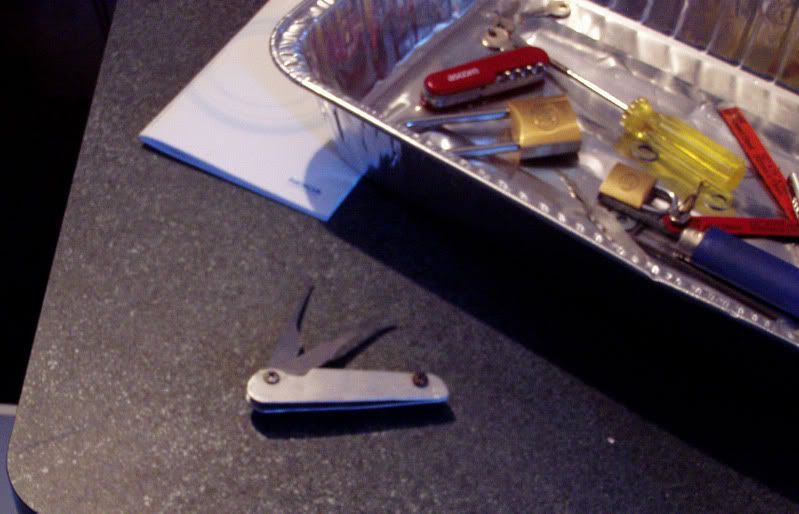

Postby mjwhit » 25 Feb 2007 1:12
i made a jacknife, using aluminuim as the outside and hacksaw blades as picks. Used washers in between picks and it works good. heres a very average photo of it but since then i have redone the picks. gives you an idea though
