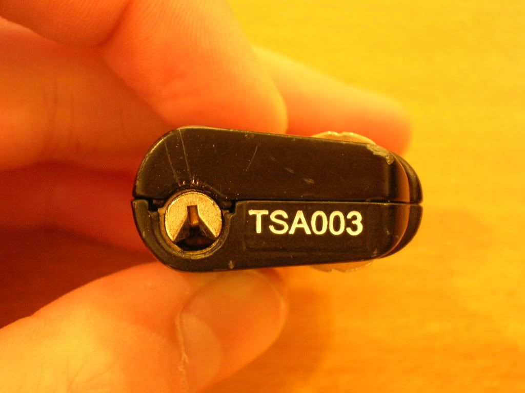

Most people who travel to the USA will usually see the TSA authorities. They check baggages and have their own line of luggage locks(all of which are not very dependable). The lock that I will be picking is the Samsonite 007 TSA Padlock. When I first started playing with this lock, I noticed that the TSA keyway was very tight and narrow, it also has a very distinct triangular keyway shape: here's a pic.
http://i175.photobucket.com/albums/w137/novicelockpicker/DSCN1278.jpg
Because of the shape of the keyway, I choose to use a safety pin, and a very thin paperclip for a tension wrench.
http://i175.photobucket.com/albums/w137/novicelockpicker/DSCN1258.jpg
Also notice in the first picture the grey "knob" that is near the shackle. That knob when picking really helps you because as you pick the lock and feel the pins bind that will slightly turn(also in part due to the HORRIBLY loose tolerances), that will tell you that you're almost there. The key to picking this lock is to put LIGHT TENSION because it will literally turn on its own! Also when picking either GENTLY rake the pins or lift them individually. I greatly advise picking them individually because you can feel each of the pins bind slightly which will help to train your fingers to feel for tension changes and binding.
Overall my conclusion is that all luggage padlocks by far are easily picked and the TSA padlock is absolutely no exception. However I do know that Abloy makes a key ring to lock keys which uses a camlock to secure a steel cable, its called the Abloy FLEXLOCK. Though, I think its better put to use as a luggage padlock than a key ring!

I'm curious. On the lock you have, you can turn the knob by the shackle to apply tension? If so that would be pretty cool.
I can't pick that one tsa lock (mine does not have any knob like that by the shackle though, i think that would help). The triangular keyway is just too wierd for me. I've heard light tension, but it does not do the trick for me.
Luckily I can read the sesame lock, so I can still say I can open it :-)
