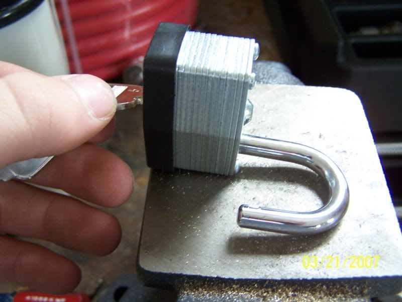

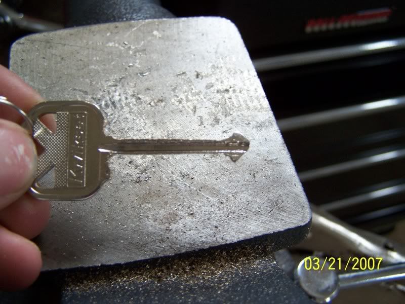

First put the key in the vice and file down to the very middle of the key
http://i97.photobucket.com/albums/l223/ ... 0_1800.jpg
You will end up with this
http://i97.photobucket.com/albums/l223/ ... 0_1802.jpg

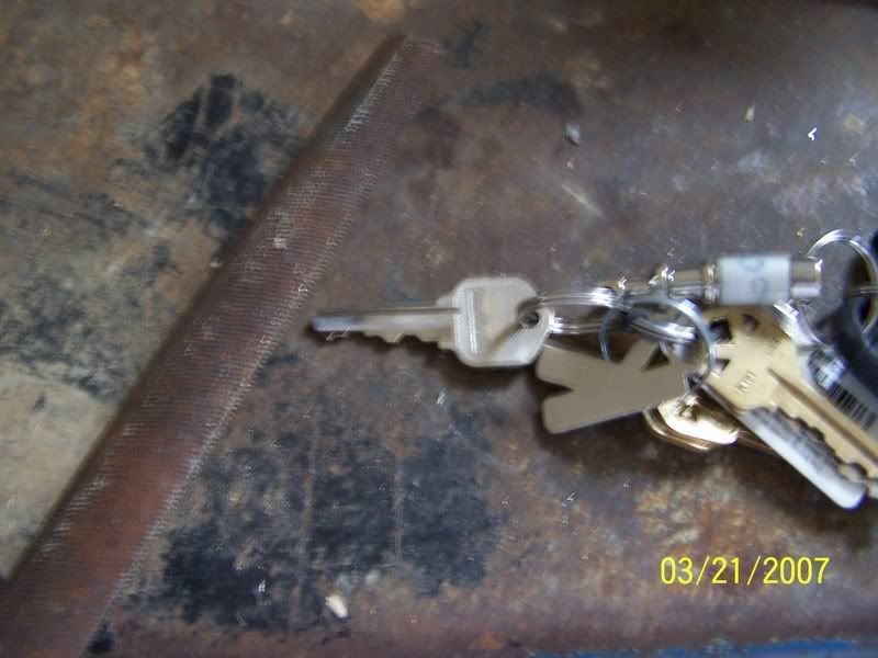

The warded lock
http://i97.photobucket.com/albums/l223/ ... 0_1803.jpg

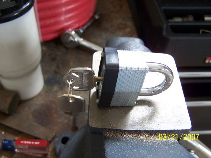

Put the pick in
http://i97.photobucket.com/albums/l223/ ... 0_1804.jpg

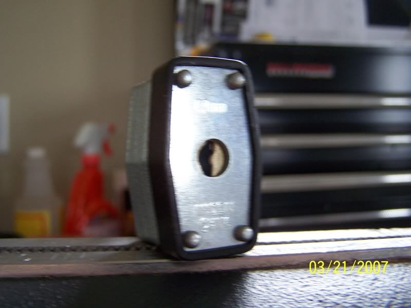

Get the pick to catch in the right spot and turn
http://i97.photobucket.com/albums/l223/ ... 0_1805.jpg
